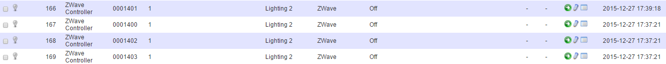

Hi everyone,
Using domoticz v2.4015 and OpenZWave Version: 1.3-572-g8282e45.
Included my ZMNHJD1 after doing the modifications above explained by lezon and syl20.
Node 20 (ID of my ZMNHJD1) is marked as dead, 4 devices has been discovered (all are Switches, none are dimmer, IDs are 0001400 to 0001403).
Is there something special to do please to have the dimmer appear and node not dead ?
Regards,
Laurent
Wirby
Posts: 6
Joined: Sunday 13 December 2015 11:55
Re: QUBINO ZMNHJD1 not compatible with Domoticz ?
Post by Wirby »
Is your controller far away from your module ?
Maybe it's just out of range.
After including my module, the dimmer appeared in the devices list as "Level".
lolomin
Posts: 21
Joined: Sunday 11 October 2015 16:48
Post by lolomin »
Wirby wrote:Hi,
Hi Wirby,
No, the controller is just beside the ZMNHJD1 (1m away only ...). I have begun with this heater because of this proximity :) I have 3 heaters to add ZMNHJD1, this is the first one for the moment.
Here is the output of devices detected by Domoticz :
ZMNHJD1_devices_detected_domoticz
Do you have any idea why it's not detecting me a dimmer please ? I have put my heater on PROG mode so this is the function that allows to control Pilot Mode.
Regards,
Laurent
