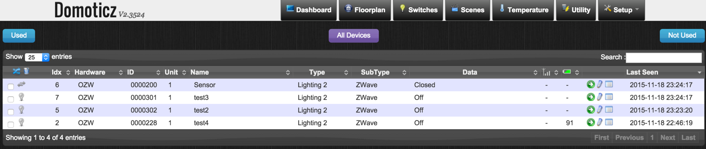

So far I had a unique door opening sensor (Fibaro FGK-101) connected through Z-Wave to my Domoticz instance running RaspberryPi.
I have purchased and plugged a DS18B20 to the FGK-101 to measure temperature.
Here is the list of devices I see in Domoticz (Setup > Devices):
Can you confirm the temperature sensor has been detected during the device association ?
What should I do next ?
Thanks in advance for your help.

for my fibaro switch, it says in the manual, then when you connect a temperature sensor to it,
you have to exclude the node, and include it again
did you try this ?

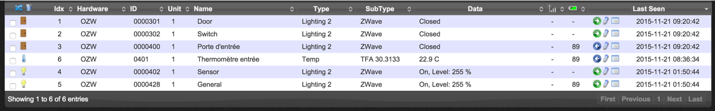

Good news!
I did the exclusion/inclusion again as you said. It was not working yesterday evening. I just throw everything in a box and went to sleep
... and this morning surprise, surprise, it does work and I could see a list with many devices :
Screenshot at Nov 21 09-33-10.png (132.89 KiB) Viewed 1567 times
I understand this was just a matter of "waiting".
