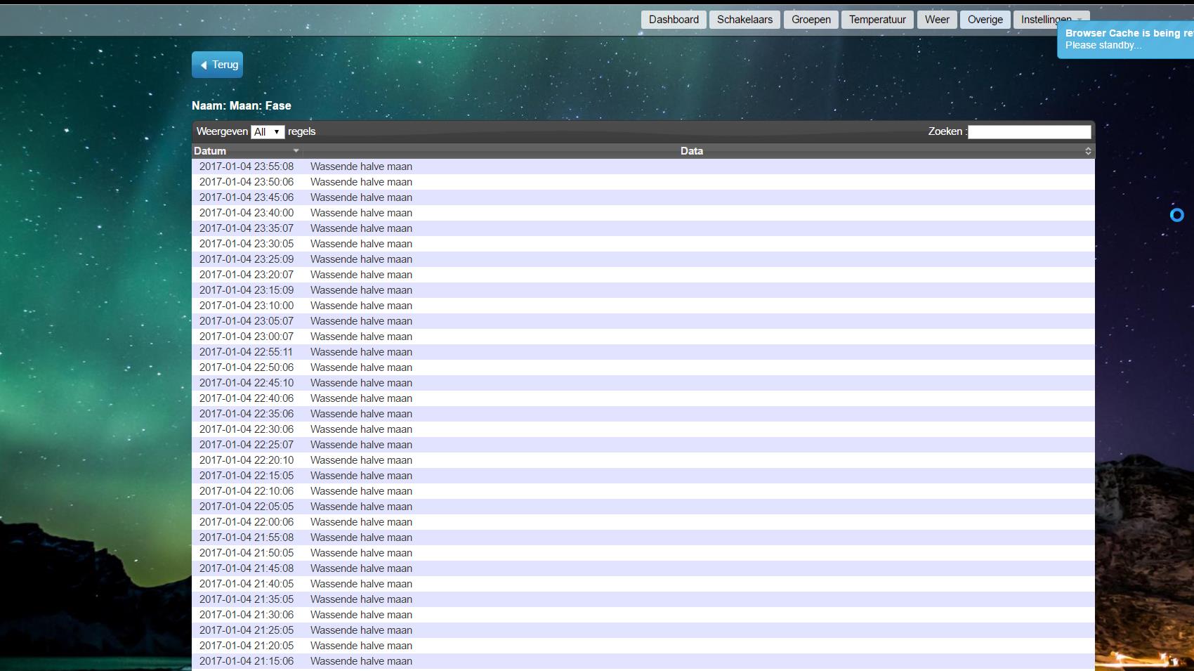

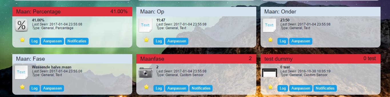

@ Bakseedaa
Thanks for this option..
Need this for my moonphase script. that runs to often so i was killing my api...
Do you have perhaps great scripts that you are running with this option?

Derik
Posts: 1602
Re: Run time scripts at different intervals than every minute
Post by Derik »
mmm something strange....
Until last night works great:
Only @ this moment....
No script running.
Is there something that i can do?
