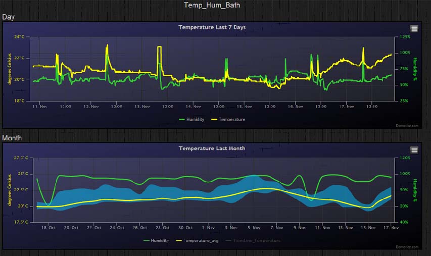

I've got a combined temperature - humidity sensor and the values for the two are displayed together.
In the "temp last 7days" graphic the correct values are displayed. One can see a rise of temperature and humidity
if somebody takes a shower.
It's the "temperature last month" that I don't quite understand: The temperature curve is an average of the temp values
and the humidity curve displays the maximum values? Because an average humidity level of 97% is just not plausible.
If my assumption is true: how can I change the legend to the graphic (for example to "Humidity (max.)" ?

your assumptions are correct, and no you can not change the legend
what would you like to see, the Average humidity of the day ?

I guess if You're staying with the value displayed (which is the maximum of humidity per day) it would make sense to write "humidity_max" or something like that.
If You're asking whether I can imagine a more useful value altogether I'd opt for an average value for the humidity with a min/max display as with temperature.
That to me would make more sense. The 98% for the humidity sensor in my bathroom are valid for just five out of the 1440 minutes per day: the time I take a shower.
So an average for the day might make more sense.
