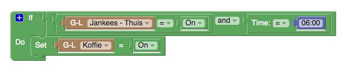

I'm trying to make my coffee machine to go on when I'm at home, but for some reason it does not work. Can anyone spot the mistake?
- Screenshot 2015-11-16 15.43.53.png (21.46 KiB) Viewed 1637 times

Should it not be Time > 6.00
Because it will only be 6.00 for 1 second?

Try using the Control without the + (Else If)

Add an "And Koffie = Off" as well to the If.

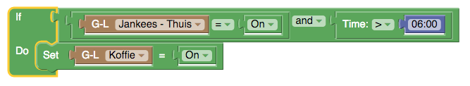

I changed the event to look like this, hopefully I have some coffee tomorrow!
- Screenshot 2015-11-16 20.36.22.png (20.69 KiB) Viewed 1582 times

That's not good, because your coffe maker will eventually be turned on every minute after 6:00 until 23:59 .... or until you reset the flag saying that you are home !
