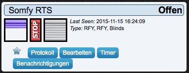

Domoticz is running stable since a month on my Synology DS-214+ with RFXtrx433E. I have two kinds of blinds-devices.
1. Somfy blinds that are switched directly through RTS Protocol
2. Older Somfy blinds with connected intertechno CMR-500
Controling them through the webinterface of Domoticz is working perfect. There are different graphical switches for both kinds as could be seen on the attached images.
With the Domotix App i can only open or close the blinds that have the connected CMR-500 but there is no possibility to stop them. The directly accessed blinds are only moving in one direction and the state of the switch in the app is mostly wrong.

For the blinds issue; It may not be the app, but the version of Domoticz. Try updating to the latest beta where the Stop command in scripts was fixed.

I don't think so. On my NAS the latest Domoticz build V2.3595 is running. Thanks to Jadahl (http://www.jadahl.com).
I also have the Pilot App installed on iPhone. With this all switches are working as expected, including both kinds of my blinds.
