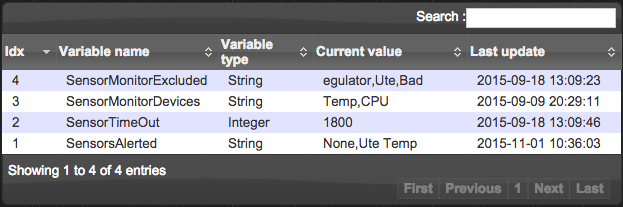

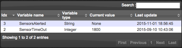

Maybe I can help .... I created the following LUA script to monitor ESIC/WT450 and other unreliable sensors. This sends me notification when selected sensors drops out, and another one if it starts responding again. You can also exclude sensors from being monitored for timeouts.
The script makes use of Domoticz user variables for configuration as follows:
  • SensorTimeOut (integer) is useful to change for debugging, or undefined for defaults
  • SensorsAlerted (string) - blank / undefined for no alerts. NB: Set to "None" as initial value for alerts
  • SensorMonitorDevices (string) - comma separated list of substrings to match for device names
  • SensorMonitorExcluded (string) - comma separated list of substrings out of the matched devices to exclude
The substring matches are intentional, and the purpose is to make it easy to include / exclude device names containing functional names such as Temp and (R)egulator.
A minimal setup of user variables can be as follows, but only SensorsAlerted is strictly needed.
Typical Variables
Typical Variables
A more typical user variable setup can look like this. In this case it displays a state where one sensor has timed out
Minimal variables
Minimal variables
Please note the needed inital word None. Just my laziness / makes the code simpler, but is required for this to work.
If you prefer, you can just use the fallback variables in the script instead of user variables. I find user variables handy as i use the same LUA script in two different houses.
