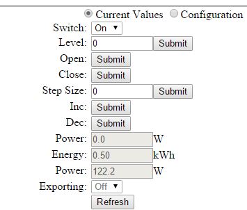

Just though of another thing I could try so went into the ZWAVE controlpanel to have a play.
I started the down motion by Setting the Switch field to "On". Then when I click on either "Open"/"Close"/"Inc"/"Dec" the down motion will stop.
Didn't capture the Debug ZWAVE command yet, so let me know in case that would be helpful to have as well.
