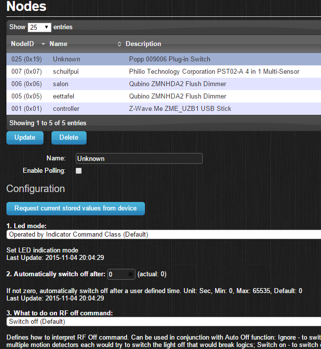

Dont know if this solve your'e issues, if you still have them.
There are are few things that are incorrect:
<Help>Defines how to interpret RF Off command. Can be used in conjunction with Auto Off function: Ignore - to switch on the ligh$ no close </Help>
<Value type="list" genre="config" instance="1" index=21"
Can you confirm you got this device working including all the options?
Compute RPi 2 : Domoticz latest beta, Synology : Domoticz tested beta on failover system.

Re: Popp 009006 Plug-In Switch - Timeout
Post by djoeney »
Have been playing around with it this is the result. Only no power measurement. I didn't get openzwave from git so can't do a dist update.
Screenshot Domoticz Popp
