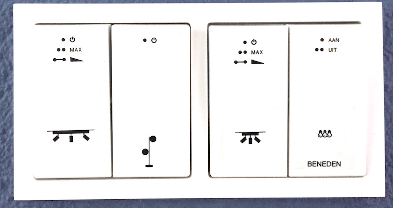

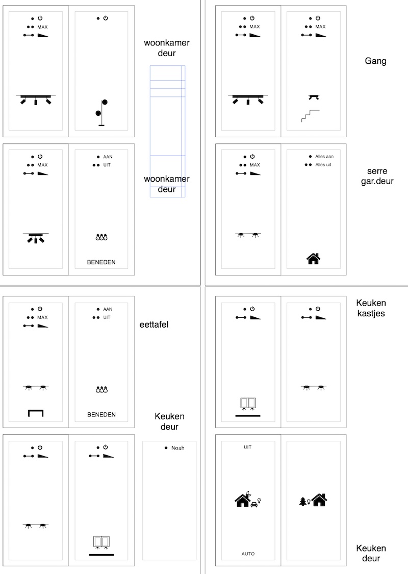

So I ordered some transparent sticker sheets that can be used in a laser printer and used that to print labels for the buttons. The labels are not entirely transparent (darkens the background a bit) but that is ok. So far it works well.

That's pretty cool.
I have gone down the keep it simple route and there is only one 'Scene' button in every room that toggles certain scenes and devices dependent on variables throughout the day. One example is on my landing between 5pm and 7pm ( bathtime for the kids ) if the button is pushed it will set a scene for the bedrooms and when pushed again set a story time scene if pushed again will reset the scene.
So my wife said ' How will I know what button to press to get the lights on'
to which I said ' Every button is exactly the same as it was ! But the scene buttons do extra stuff. Just push it and see what happens. If you don't like what happened press it again and it will reverse it'
This way anyone in the house isn't afraid of pushing a button just in case they make a mistake.
However. I love the transparent labels. At the moment i'm using grid modules and the scene buttons are a different colour. This is great for wall switches that have more than 2 modules because it is obvious but for the others a sticker might be helpful.
