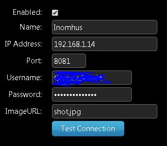

Added this to wiki:
Android Phone (Tested with Sony Xperia V) using this app: https://play.google.com/store/apps/deta ... pas.webcam (Change default port!) image URL: shot.jpg
The android app Ip Camera works great to connect to domoticz.
I have it running now for 48h with domoticz and motion connected to it. Works great.
Default port is 8080 so change that if you run Domoticz at default port.

Don't work for me.
I see the video in 0,2 sec and than it is just nothing.
What are the correct config?
EDIT: Working

Hi!
The images only shows for 1 second when you press test connection... but it works if you add it and use the camera menu.
I have also not the /shot.jpg but i use shot.jpg
