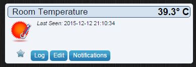

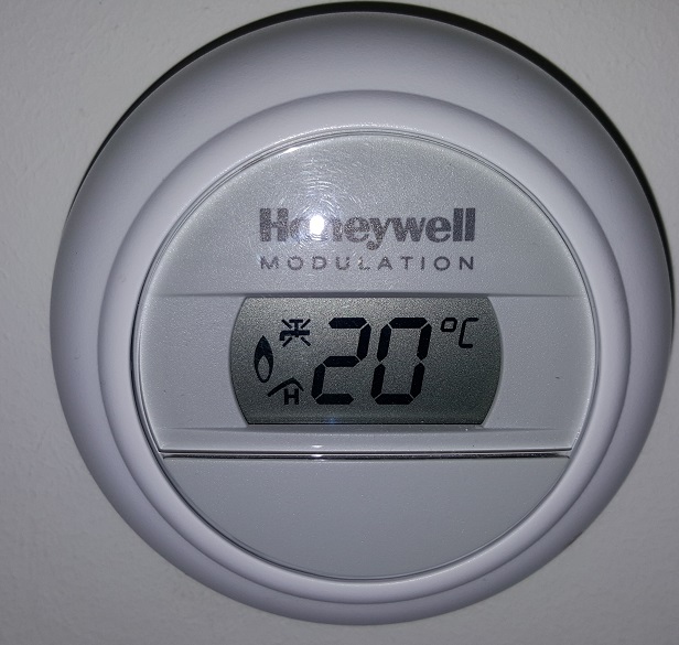

Hardware: Agpo Ferroli Megalux 6 & Honeywell Modulation. (OTGW + USB)
General problem I have now is that Domoticz thinks it is hell warm in my room.
Display on Agpo shows the correct temperature....

A well the 4.2.5 firmware issues are over!
OT Monitor is running fine now.
However:
Anyone that can explain this strange behaviour in Domoticz???
OT Monitor shows temperature just fine.
Really appreciated.
