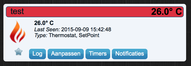

Setpoint of the Qubino on/off thermostat ZMNHIA2 isn't updating the Qubino Module when entering a number, it is in the interface.
And isn't update with the up- and down arrows in the interface.
Schermafbeelding 2015-09-09 om 17.48.37.png (63.06 KiB) Viewed 4241 times
Getting this error in OpenZWave control panel:
2015-09-09 18:51:22.473 Error, Node006, ERROR: Dropping command, expected response not received after 1 attempt(s)
Then it reset to 0 again.
