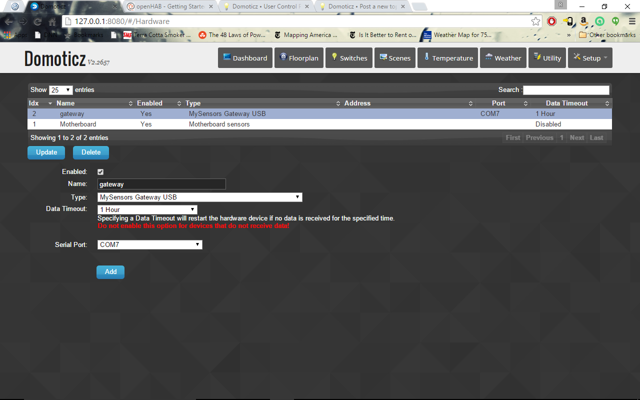

Looking for a helping hand. I have the following (I am only about 3 hours into this so please be basic);
- Windows 10 PC with Domoticz latest release going
serial gateway
- Arduino Uno (real) with NRF24L01+ done just as shown on this website
http://www.mysensors.org/build/serial_gateway
First Sensor
-Arduino Uno (real) with NRF24L01+ done just as shown on this website (have a 135 instead of a MQ2 hooked up)
http://www.mysensors.org/build/gas
I hook up the gateway and set up hardware. I go to COM7 (where the gateway is) name it and add it. I see nothing confirming it is working. Thoughts?
I have the gas sensor across the room plugged in, nothing shows up in devices.
Am I missing a critical step here?
here is an image
https://www.amazon.com/clouddrive/share ... _link_copy
- 1.png (200.23 KiB) Viewed 7202 times

sendSketchInfo("Test Gas Sensor", "1.0");
present(CHILD_ID_GAS, S_AIR_QUALITY);
void loop() {
int gasvalue=123;
Serial.println(gasvalue);
send(msg.set((long)ceil(gasvalue)));
// Power down the radio. Note that the radio will get powered back up
// on the next write() call.
sleep(SLEEP_TIME); //sleep for: sleepTime
