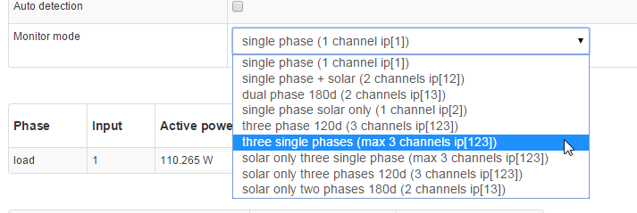

You obviously know more about Smappe than I do, how do you divide your home into 3 meters? Do you need to buy 2 more meters? Or is this via the software?
Currently I think Smappee will be returning at least 2 if not 3 values to you, "consumption", ("solar" 0) and "alwayson". I am not using the "alwayson" value. So I guess with a 3 phase system and solar, then Smappee would return 5 values.
How successful are have you been with identifying your appliances with the Smappee system?

mcduarte2000
Posts: 24
Joined: Friday 17 July 2015 5:12
Re: Smappee Support?
Post by mcduarte2000 »
simonrg wrote:Currently I think Smappee will be returning at least 2 if not 3 values to you, "consumption", ("solar" 0) and "alwayson". I am not using the "alwayson" value. So I guess with a 3 phase system and solar, then Smappee would return 5 values.
I contacted support some weeks ago to understand what the non-documented "Monitor Mode" -> "three single phases" meant. They confirmed me it would allow me to have 3 clamps. (check the attached print-screen)
