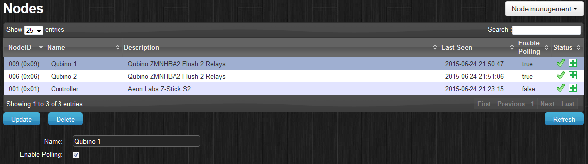

I had same issue with my ZMNHBA2. What I did is to "Enbable Polling" and the staus is now reported properly in Domoticz
Capture Z-Wave 11.png (61.93 KiB) Viewed 14249 times
Not sure it'll work for your ZMNHB02 but you can try.

I already had polling enabled.
