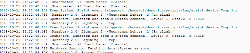

Weird,
I get a response in my log.
Did you add it as an device in devices tab?
Mischa
Mischa
