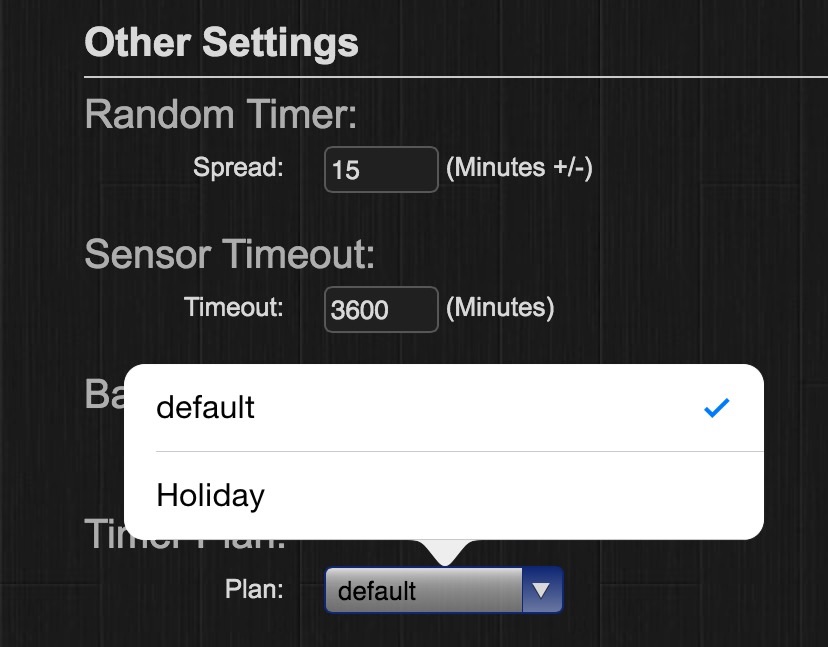

I would like this possibility as well.
So to be able to switch the timer plan (Settings, Other) from default to Holiday and vice versa. See picture below (scroll down for setting).
Is it possible to do this via a script?

Thanks to @dnwppo it is now possible to switch between Default and Holiday timer groups using a virtual switch.
Add the following in the On Action of the switch to activate the Holiday timer:
http://127.0.0.1:8084/json.htm?type=command&param=setactivetimerplan&ActiveTimerPlan=1
In the Off Action to activate the Default timer:
http://127.0.0.1:8084/json.htm?type=command&param=setactivetimerplan&ActiveTimerPlan=0
See more information on https://github.com/domoticz/domoticz/co ... d2ec61cb8a.
