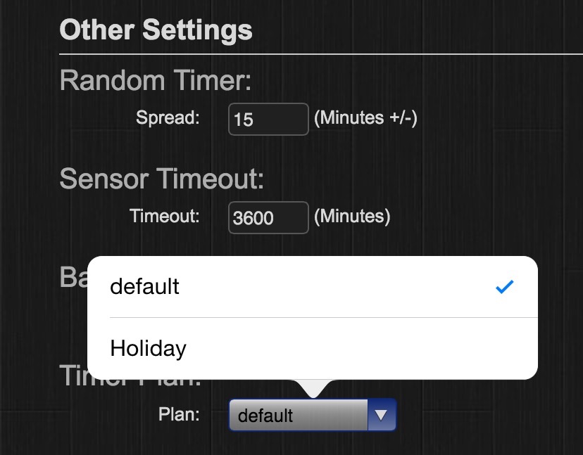

I would like this possibility as well.
So to be able to switch the timer plan (Settings, Other) from default to Holiday and vice versa. See picture below (scroll down for setting).
Is it possible to do this via a script?

Does anyone know if this is possible or not?
I want to be able to set Domoticz in holiday mode (changed timers, receive notifications etc) with one virtual switch.
