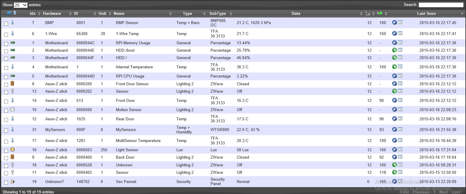

Hello
I have connected my sensors gateway via usb, and it seems to be working fine for a temp/humidy sensor. Unfortunately it doesn't work for a Relay Actuator. I can see under domoticz log that Relay is detected (see attachment), but It doesn't appear under devices list. Can someone help please?
- Domoticz device list
- domoticz device.jpg (268.63 KiB) Viewed 16604 times

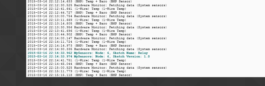

- Domoticz log
- domoticz.jpg (93.15 KiB) Viewed 16604 times

The log displays that there is a node plugged in, and its reporting the sketch name/version.
However, it does not receive anything (as i can see in the log)
I think this 'relay' (switch) node, is not sending the 'current' switch state to the serial controller ?
Please modify your code a little bit
Do you load/save the state (as in the RelayActuator example) ?
(strongly advised)
Then after sending the sketch info, load the current state,
gw.loadState
- set this state to the real output (digitalWrite or similar call)
- send this state to the serial controller
// Change to V_LIGHT if you use S_LIGHT in presentation below
MyMessage msg(CHILD_ID,V_TRIPPED);
gw.send(msg.set(value==HIGH ? 1 : 0));
When you receive a command from the serial controller (to switch a relay), store this state
gw.saveState(message.sensor, message.getBool());
This has multiple advantages:
- when there is a power failure, the relays will automatically be set to the last state
- and domoticz always has the current state

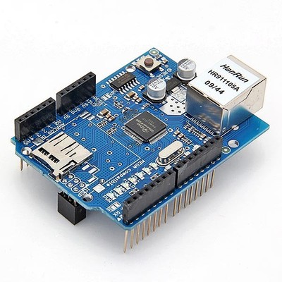

I just build my first mysensors ethernet gateway
It is working
i had a W5100 ethernet shield (for uno), and a arduino nano.
http://i.ebayimg.com/00/s/NjAwWDYwMA==/ ... 880000500F
i connected the shield with the arduino via the ISCP connector, and also wired pin 10 (nothing more is needed to get the ethernet part working)
connected the NRF24L01 Radio module.
Loaded the MySensors ethernet sketch, modified:
- ip address, nothing more
But, you also need to modify the below files (and revert the changes when you have uploaded the sketch)
- libraries/MySensors/MyConfig.h -> remark the #define DEBUG
- libraries/MySensors/Utility/RF24_config.h -> unmark/remove the slashes in front of #define SOFTSPI
Uploaded the sketch, and in domoticz added the MySensors with Lan interface hardware type, ip address, port = 5003
working perfectly
Not sure if i will use this big shield, there is also a small one
Ps. there is a new beta that should work better with the V_LIGHT/S_LIGHT examples
/Rob

@gizmocuz Are you able to turn relay on and off? I've tried to make the EthernetGW work but It seems that I only get oneway communciation, sensors logs to Domoticz but I can't send anything to the sensors, I have a LED attached to a sensor with the Relay software on it. It works using serialgateway and the ethernetGW works when testing with the MYSController
. Is there any setting in Domoticz to turn on/off twoway communication when using ethernet?
