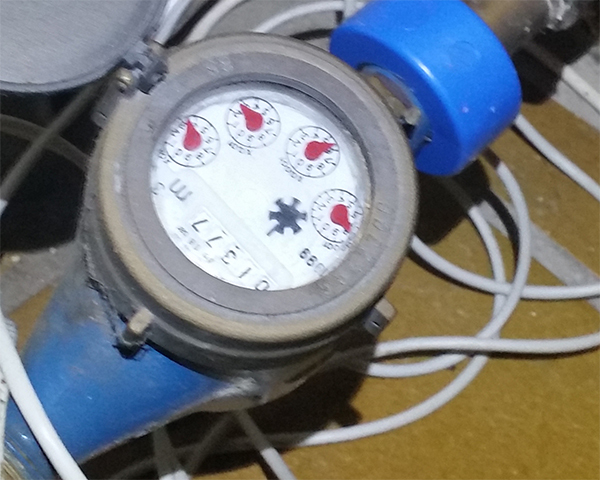

I have connected my Smartmeter and come to the conclusion i am missing another meter in my metercabinet. Water!
I have read a thread on this forum http://www.domoticz.com/forum/viewtopic ... 1&start=20 about the gasmeter reading. I want to try this module: http://www.dx.com/p/tcrt5000-black-and- ... car-140732 and connect it to GPIO
I have ordered it to give it a try. It can't hurt to try since it only cost a couple of bucks. I haven't got a very nice watermeter for this purpose, so i am hoping to detect the rotation of one of the red dials. If it doesn't work, well, bad luck.
It will take some time for the hardware to arrive, but i'll keep you posted about any progress that make (or any failures for that matter)

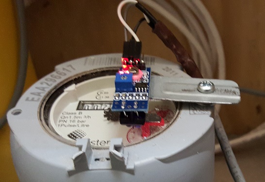

For TCRT-5000 position it wiseley just on the glass.D'rMorris wrote:Ah yes, the famous isrcounter, found that one as well (I use wiringpi as well). Never got around to test it. My issue is that when there are too much interrupts, the gpio does not capture them. Something in the logs with interrupt in queue, skipping interrupt or something. Does the isrcounter fix this as well?
Facing straight down.
Adjust the screw it will give you at least a solid valid on / off (this doesn't prevent jumping of the interrupt, that will happen eventually)
Using the script attached it will poll the pin value in stead of the interrupt catcher.

Latest watermeter mount based upon tcrt-5000 sensor
- Watermeter mount
- watermeter-20151202_203157.jpg (89.71 KiB) Viewed 11683 times
