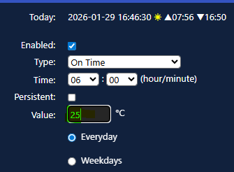

I would like to add a timer to a Thermostat Setpoint using the api but the "addtimer" api command does not an to
When a Timer is created on a Thermostat Setpoint device through the UI it is possible to include a setpoint in the values:
I can inspect the timer information that has been created using the "getschedules" API command:
"Active" : "true",
"Date" : "",
"Days" : 128,
"DevName" : "Test Setpoint",
"DeviceRowID" : 607,
"IsThermostat" : "true",
"MDay" : 0,
"Month" : 0,
"Occurence" : 0,
"ScheduleDate" : "2026-01-30 14:48:00",
"Temperature" : "25.0",
"Time" : "06:00",
"TimerID" : 1,
"TimerType" : 2,
"TimerTypeStr" : "On Time",
"Type" : "Device"
When I compare this data to the data from a timer created on a switch, I can see differences with the available properties:
"IsThermostat" is set to false for the switch
"Temperature" does not exist for a switch
A switch timer has options for "Level" and "TimerCmd" that are not available to the Thermostat timer
When I create a timer for this Thermostat Setpoint device using the "addtimer" API call, the timer is created with the "IsThermostat" value set to false and no option for adding a value for "Temperature".
Is there a way to create a timer on a Thermostat Setpoint device, which sets the temperature, using API?

Normally do an task via the standard webinterface triggers all the info you need! Go into dev mode (f12) on your browser, perform the task and check under the network tab the url performed for that task.
More info available in the forum: viewtopic.php?t=44249

Many thanks for that.
There is an undocumented API call (AddSetpointTimer) which does everything I need.
Your help much appreciated.
