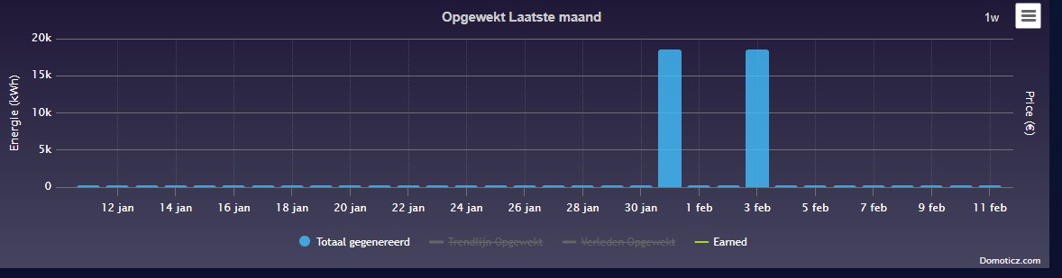

i am seeing 2 counter jumps on 31 january and 3 february. Don't know where it's comming from. Are there others users seeing those counter jumpings, in my case only the envoy production counter?

- Posts: 7020
- Domoticz version: 2026.3
Re: Envoy not communicating after restart Domoticz
Yes, there are others, see https://github.com/domoticz/domoticz/issues/6516Rik60 wrote: Wednesday 11 February 2026 15:35 i am seeing 2 counter jumps on 31 january and 3 february. Don't know where it's comming from. Are there others users seeing those counter jumpings, in my case only the envoy production counter?
