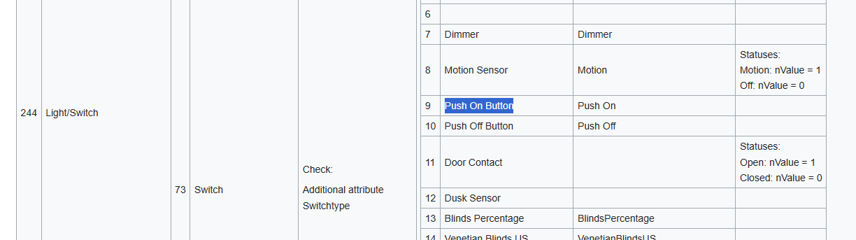

Is it possible to create a Push On Button in a python script ?
2026-01-25 20_26_00-Dzvents scripts - Verkenner.png (20.91 KiB) Viewed 3228 times
I want use a Push On instead of a switch
            if 6 not in Devices:
                Domoticz.Device(Name="Load Start URL", Unit=6, TypeName="Switch").Create()
madpatrick
Posts: 889
Domoticz version: 2026.1
Re: How to use a Push On Button on creation
Post by madpatrick »
Found it
Domoticz.Device(Name="Load Start URL", Unit=6, Type=244,Switchtype = 9, Subtype = 73, Used=1).Create()
