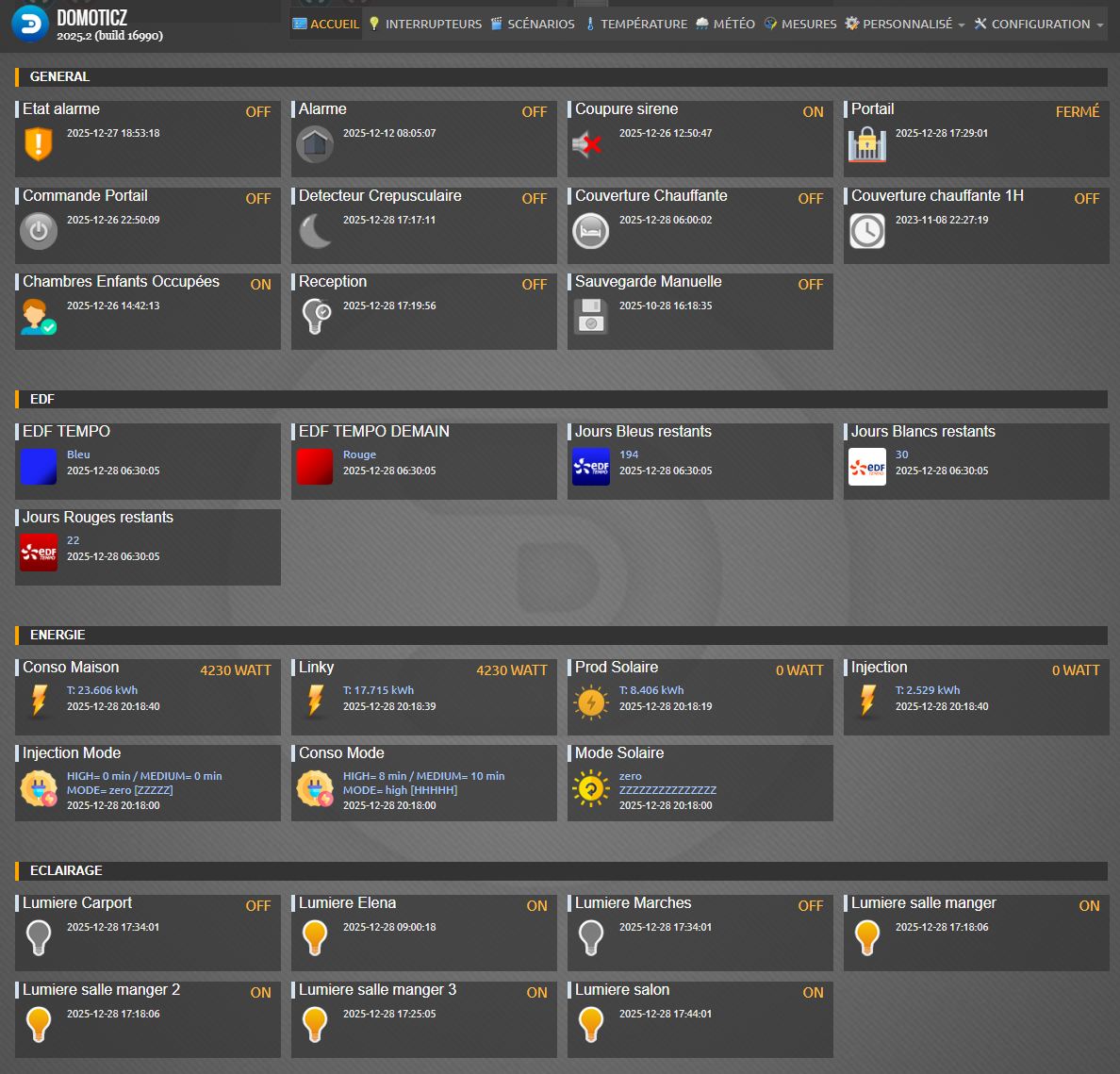

Hi All
Just for those interested I just developped a custom.js script based on DarkTheme that allows you to group your favorite devices by Rooms in the dashboard instead of having to select a room in the combo box (I wanted all displayed on my phone dashboard)
idea is to have different types of devices mixed in Rooms (or places) sections to make it easier to manage.
For this you just need to add your favorite devices into different Roomplans then the script extracts both rooms and devices to create the groups
Order is defined as per your room order and devices order inside each room (the drag and drop is no longer available)
is there is no room associated to a device, a section others will be created at the end of the dashboard to show them.
here is the result and as you can see the scripts took my rooms General, Energy and lighting to group devices in (including scenes)
2025-12-28 17_28_53-.jpg (184.92 KiB) Viewed 77 times

espace vertical and espace horizontal sets the distance between tiles
marge section is the space before the section bar
custom.css is also modified as follow :

domoticz on Raspberry Pi + RFXcom LAN moded

Re: Dashboard Enhancement : Devices grouping by Roomplans
Post by sebitop »
V189
- avoid conflit with others customs pages
- minor bug solved in retrieveing devices
- section title in bold
- extend or collapse sections capability added
