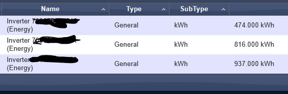

I’ll have a closer look at it tomorrow, but this is how Domoticz is receiving the values.
These are day value's, this must be 0,474kWh 0,816kWh and 0,937kWh
Posts: 6677
Domoticz version: 2025.1
Re: MQTT autodiscovery
You because you did not do what I advised......
Change into the pv2mqtt.py config topic
"unit_of_measurement": "Wh"
"value_template": "{{ value_json.WH }}"
Piacco
Posts: 81
Joined: Friday 14 November 2014 9:33
Post by Piacco »
Oops, my reading skills are not the best! You were right—I've switched it to 'Wh' and voilà, the values are finally behaving. Thanks again!" 😄
