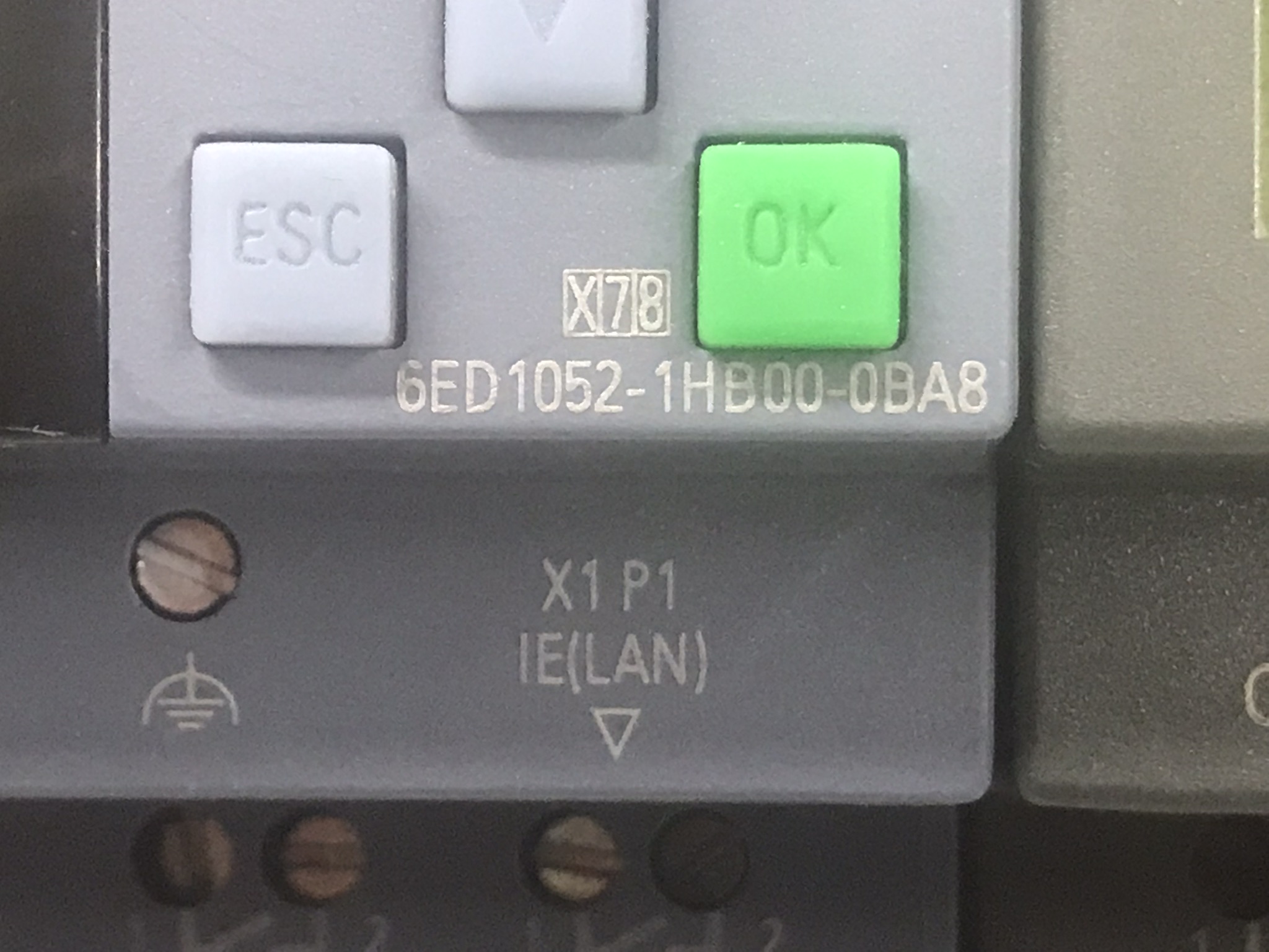

My Logo is OBA8 and here is the exact model:
If there is another model that can be communicated, I will buy another model because I noticed useful functions in the logo that I can use in my automation.

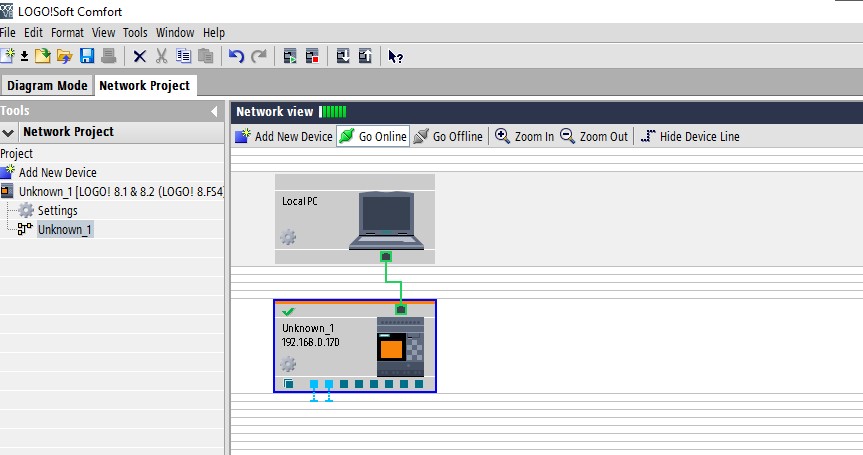

After logging in to Logo, I found the following data in the Logo Soft Comfort program:

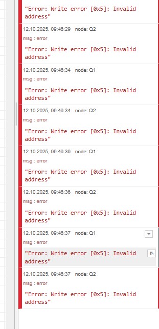

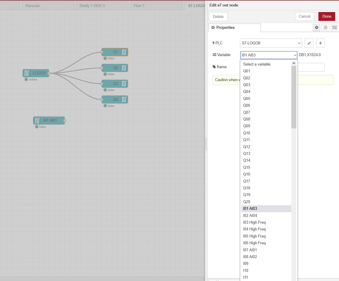

The connection seems to be working because I've added four outputs, Q 1 - 4. There's just something strange going on. When I physically violate the input on the LOGO that activates OUT 1, the state of all the blocks in NodeRed changes from false to true – so something isn't working properly.
There are some errors in red on the sidebar.

That is an important fist step, that Node-RED is able to communicate with ypur Logo9 PLC
You can try now to load the example from: https://flows.nodered.org/flow/f36b5e6e ... eb45cbad0d
Test this and see if this functions. Do not forget to change the configuration, if they are different.

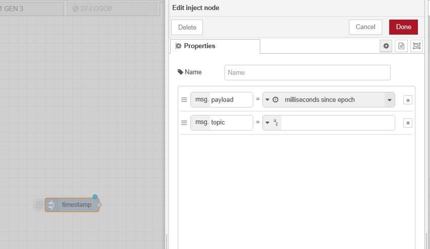

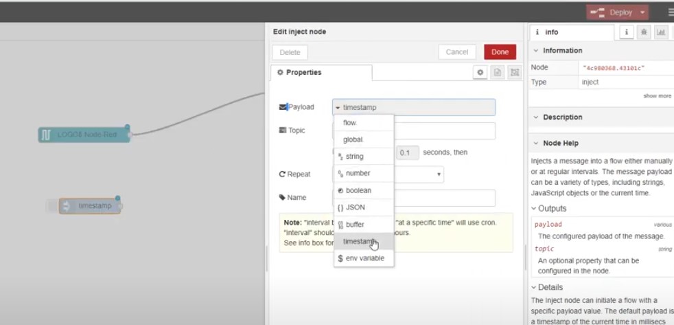

I tried both videos - in the first one, I have slightly different options in the nodeRed blocks.
In the film:
At my place In the second video, it works fine, but it's only the input state. So, when I click IN on the controller, the state only changes for the duration of the click. We want to see the relay's state and also be able to control it from Domoticz.
I don't know if this is a realistic connection.
The question is, what exactly do I need to achieve?
I understand that:
In Node Red, I need to see the status of the relay on the LOGO, and I need to control the relay on the Logo from Node Red.

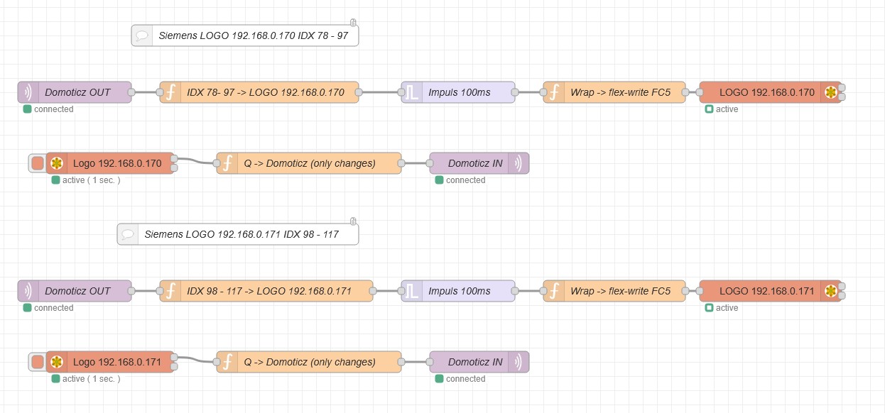

Hello, after a long time - this thread has started.
Currently, I have two Siemens LOGO PLCs at home connected to the LAN and controlled by Domoticz via NodeRed.
Everything works well and stably.
The flow created with ChatGPT took several days of testing, failures, and doubts, but it finally worked, and everything works perfectly.
I'm attaching the entire flow for my colleagues to review and to see if it might be useful to someone else.
I think a PLC is an excellent lighting controller – stable, resistant to interference, etc., and, after all, used in industry.
