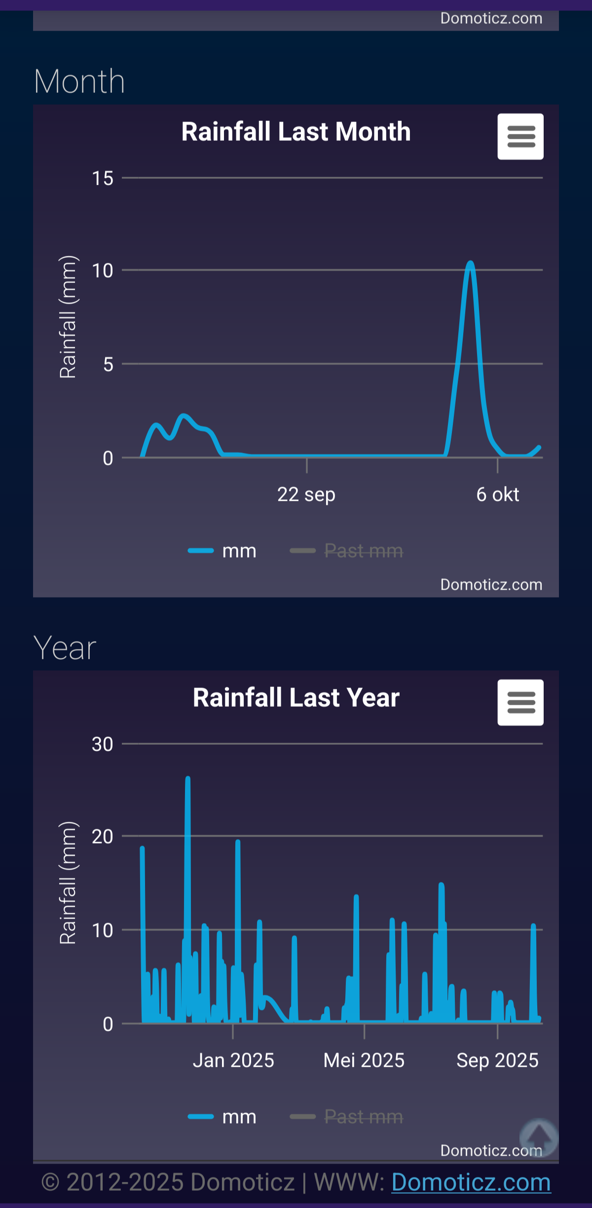

This is how it looks for me for a rain gauge, filled by an internet weather service ( Dutch buienradar). I am happy with this....
I do not use Dashticz, better ask a question in the dastcz sub forum.

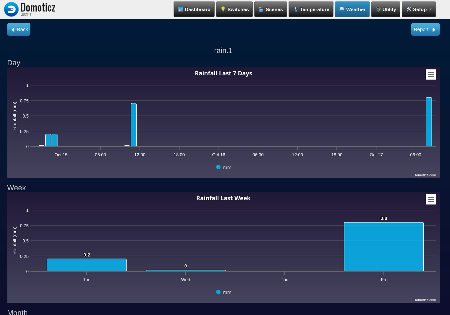

Hi, rain guage issue details. It still fails but not in the mysensors. It is clear the domoticz is the root cause.
I attaching a clear picture of a chart and db list.
- Today hit the sensor twice according to the database.
- The chart does not show the events at all
- it is 9:00 now and the chart show 11:00 ??? WTF
- interresting also is the bucket increments by 0.2 and I see in the db it incremented by 0.1 ? (bucket size is constant in my guage and I do only addition)

The cahrt shows 0.8 mm rain fall instead of 2 mm. Not a mysensors issue.

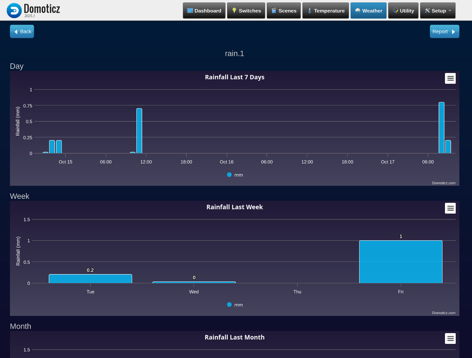

The label should fix the issue definitely... The chart is finally better - the domoticz only ignores the first record, so the number is -1 bucket.
2025-10-17 09:20:00|13476.1|100
