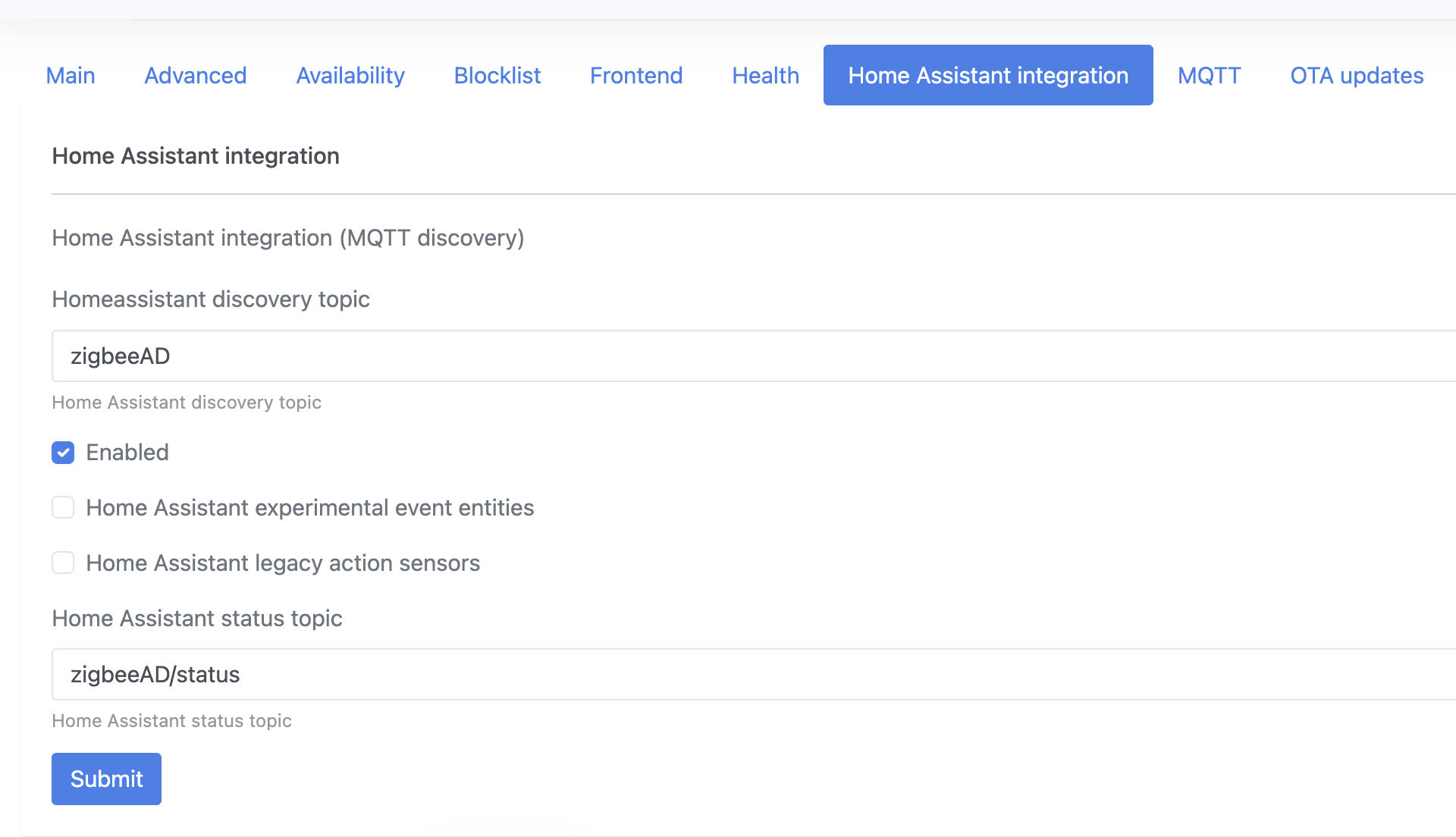

Setting in zigbee2mqtt: Homeassistant discovery topic ' zigbeeAD' (basetopic = zigbee2MQTT)

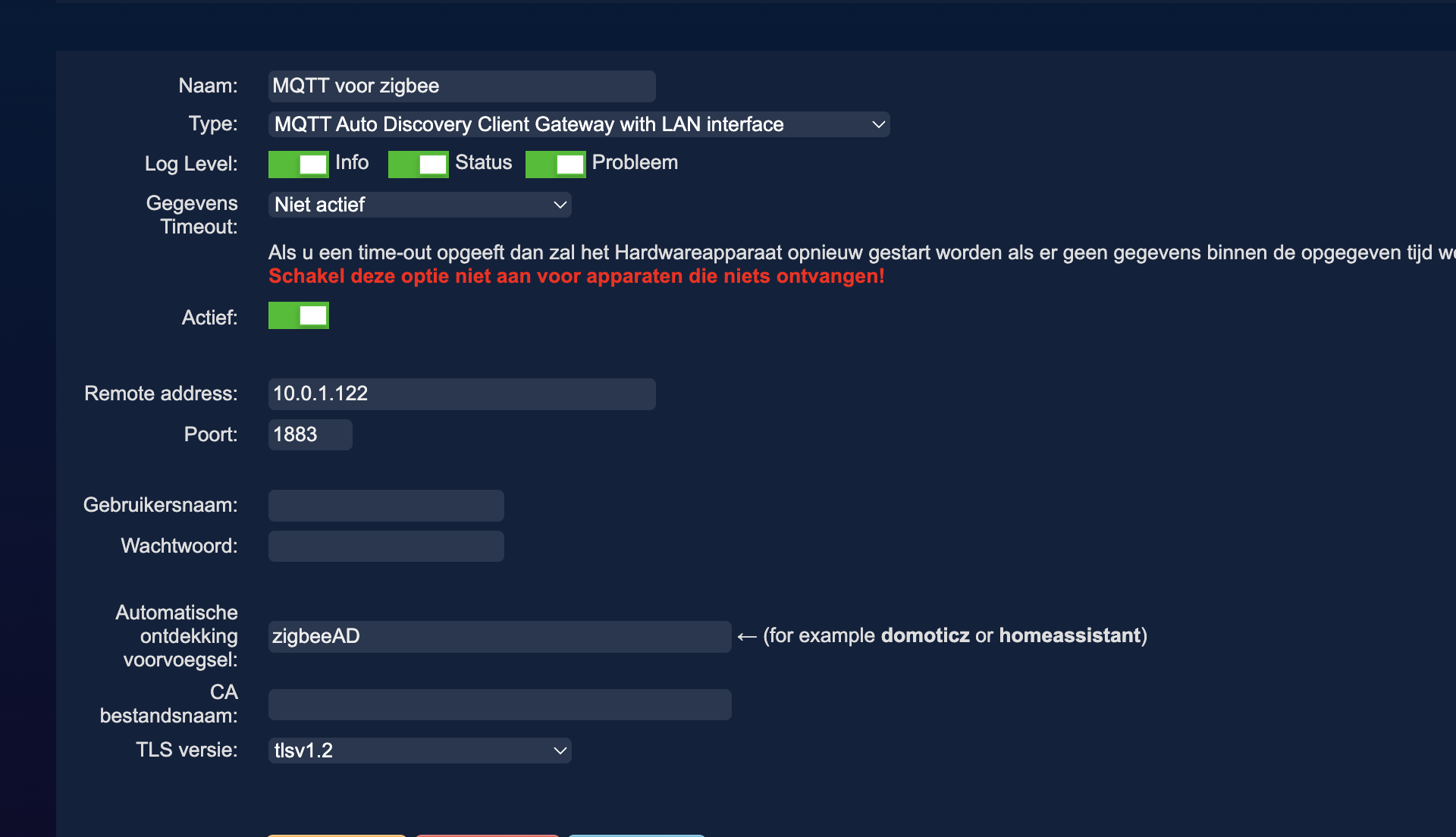

Setting in Domoticz: MQQT for zigbee (autodiscovery client gateway with lan interface) 'zigbeeAD'

In Domoticz, I refer to 'zigbeeAD' under auto discovery.

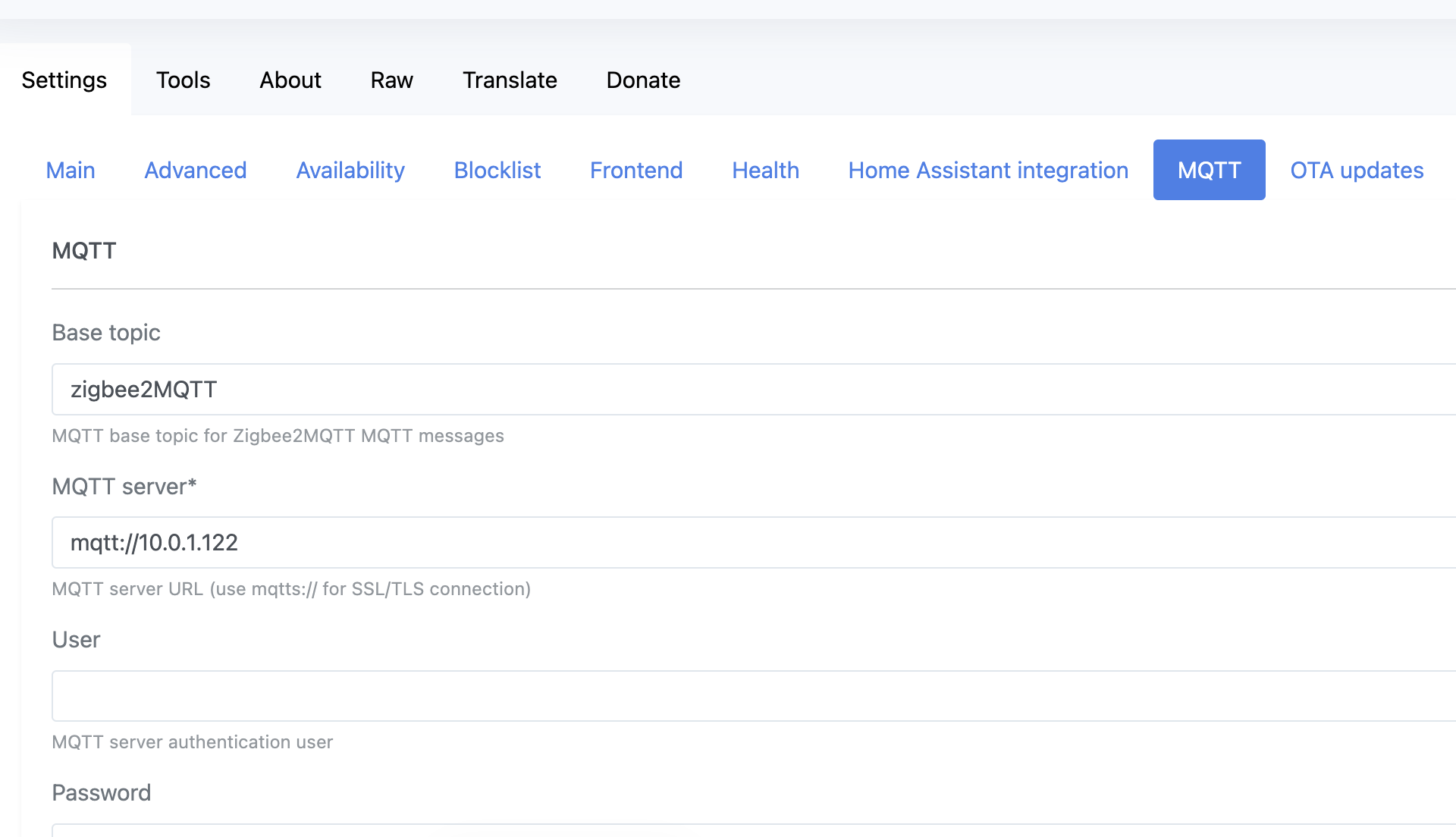

The MQTT settings for zigbee2mqtt (YAML file):
mqtt:
base_topic: zigbee2MQTT
server: mqqt://10.0.1.122
I suspect that MQTT in/out isn't working properly, causing new ZigBee devices to be properly discovered in Domoticz, but the sensorstatus aren't being instantly passed on via MQTT. Does anyone have any clues to a solution?

setting zigbee2mqtt
setting zigbee2mqtt
Scherm­afbeelding 2025-10-12 om 15.50.12.png (157.74 KiB) Viewed 40 times
mqtt settings
mqtt settings
Scherm­afbeelding 2025-10-12 om 15.51.49.png (138.02 KiB) Viewed 39 times
domoticz
domoticz
Scherm­afbeelding 2025-10-12 om 15.53.22.png (198.1 KiB) Viewed 38 times
