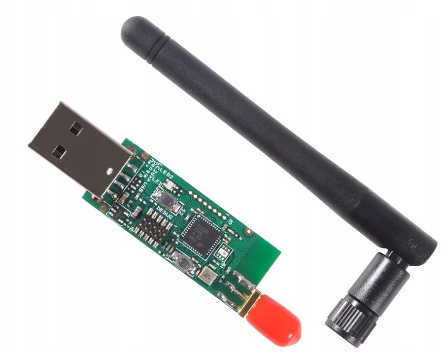

So I definitely need to start with ZigBee.
What device should I buy that's compatible with the Raspberry Pi on which I have Domoticz?
I once bought a CC2531 for this purpose, but it's sitting on a shelf. Will it be suitable for this purpose?

It can be used but is not powerful enough. Better buy a sonoff zigbee stick. For example SONOFF ZigBee 3.0 USB Dongle Plus, TI CC2652P Coordinator, Universal USB ZigBee Hub, ZigBee Gateway for Google Home https://amzn.eu/d/c3WdeOs

You do indeed, that will work but it's very old now, I think that will only support 32 direct connections. I use one of these :-
https://support.electrolama.com/projects/zig-a-zig-ah/
I am going to upgrade to the SMLIGHT SLZB-06p7 as it's IP based and supports POE so you can put it anywhere you have an ethernet port. Have a good search around if you want to use one of those as the prices vary wildy, for instance on Amazon in the UK it's £109 but from Aliexpress its £30

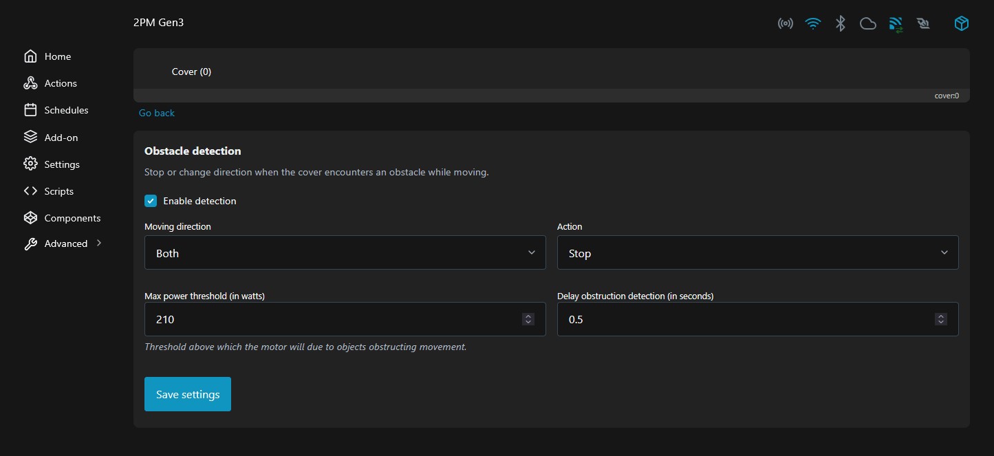

You never know what the future will bring; you might need to switch to Zigbee.
Generally, I think that if the device is a newer generation, it's better, more durable, works better, etc.
Generation 3 also has obstacle detection, but I don't know how it works; I haven't tested it.
The Shelly 2.5 series also had it, but unfortunately, it didn't work.
