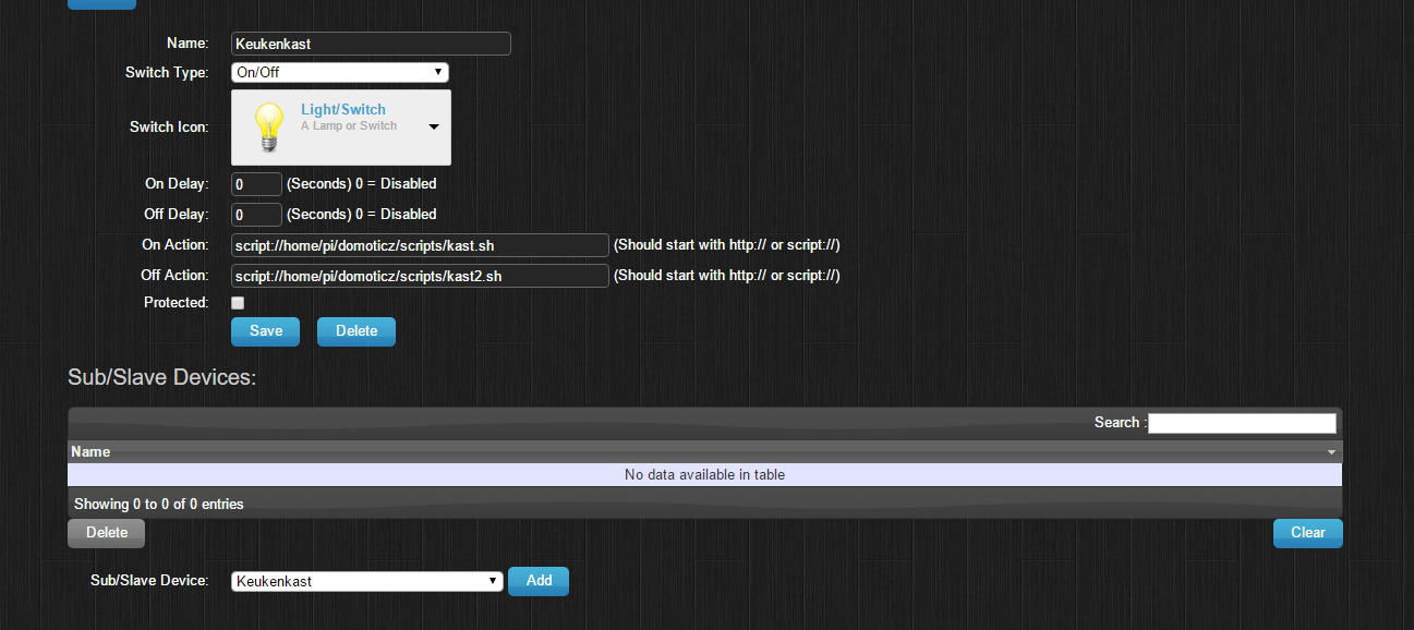

Ok putting all info together I finally got it working.
I didn't however put the commandline in the script path but the path to the script which contains the commands. Maybe a bit overdone but the command didn't work for me to put it in the scriptpath in fist instance.
So now I've got two scripts which are placed in the /domoticz/scipts folder
One is named kast.sh and looks like this.
I found out that making a script is not only done by making a text file. I had to run this
To change the file so it is recognized as a script.
Now inside domoticz things look like this:
#!/bin/bash
sudo /home/pi/433Utils/RPi_utils/codesend 16404Code: Select all
$ chmod +x kast.shNow inside domoticz things look like this:
- domo.jpg (384.21 KiB) Viewed 9389 times

Koensk
- Posts: 33
- Joined: Friday 25 September 2015 9:23
Re: Using RTL_433 app as reciever
uhm.
Things stopped working here.
I don't know why but the scripts still work when I give the command in putty. But Domoticz seems not be able to run them anymore?
Maybe because I ran an update of the program to a more recent version?
Anyone any idea?
Anyone any idea?
Works fine in v.3586 for me
Double check your switch settings. On Action should be looking like "script:///home/pi/.........../codesend ******" (please note three slashes after the script)
Koensk
- Posts: 33
Ok I put the codes in like you suggested but I had to run this command first: "sudo chown -v pi codesend"
Now it al works again
Thank you

I'm using a cheap RTL_433 receiver to record information from a wireless weather station.
In order to do so I wrote a small script that receives the information, does a bit of formatting and then publishes the information using MQTT.
In Domoticz I've setup a couple of devices for Rain, Temperature and Wind.
The script publishes the information for these devices based on their Idx in JSON format.
Works like a charm.
