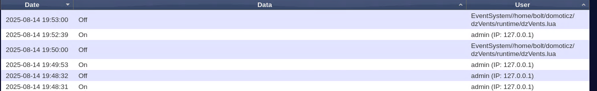

one of the reasons i did not see it in the log it only recorded the on switch
if it showed off switch (while it was already off) and then an on switch i would have noticed earlier
in the original script i have 2 triggers which only trigger at a specific timeframe.
however, once the script is triggered by the timer it does not check anymore what triggered the script and just execute the second if-then statement.
thanks for helping me out Walter and really stupid i did not see this earlier

Re: .switchOff() command switches switch on
Nice solution. i do the same but have no switch in the esp, only a relay which is controlled by a switch in domoticz.
for me the right status of the relais is always domoticz.
when you reboot or switchoff the esp it looses it's status.
on esp reboot's i initiate a mqtt broadcast, domoticz is sending out the status of all switches.
i use the generic mqtt import function in the esp to filter out the status of the relay and set it again.
maybe there is an easier way to do it (checking the status of a domoticz switch from esp) but this is what i came up with a couple of years ago.
maybee the esp will survive a cold and hot boot now, not sure
