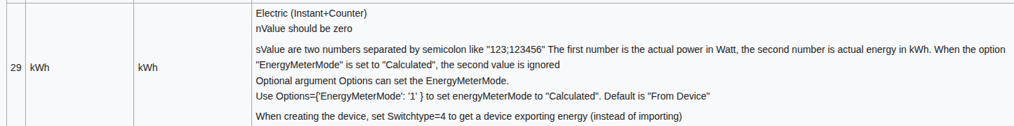

1) First I create the kWh device using the plugin with the default "from device" setting (leave the options field empty when creating the device).
2) Immediately after creation, I update the device svalue to "0;0" using the plugin.
3) and then immediately I update the options field to 'EnergyMeterMode': '1' which changes the device to "computed" instead of "from device".
Note in step 3 the update statement needs to be run with the UpdateOptions=True flag like this
Devices[DeviceID].Units[Unit].Update(UpdateOptions=True)
Now it has an initial value and future updates will work.

I had to deal with that same problem:
At first, I'm creating the device (lib Domoticz) with the options, using Typename (cause when using Type and Subtype, it was not working)
Then I init the device with svalue = "0;0"
then updates are ok

I'm not 100% sure that the Option for EnergyMeterMode is made to be set during device creation
Capture d’écran du 2025-09-06 17-19-08.png (43.33 KiB) Viewed 192 times
source: https://wiki.domoticz.com/Developing_a_ ... vice_Types
I don't understand why you absolutely want to set options at device creation.
Try this : don't create the device with options, only use options for update process. You should not need to add fake value, and the update will work.
