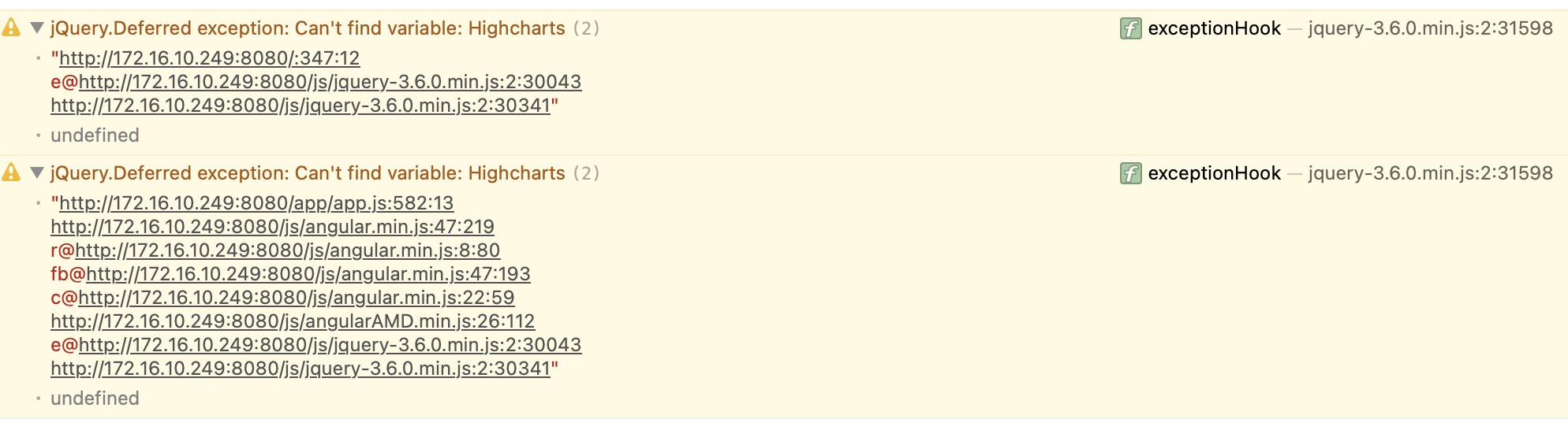

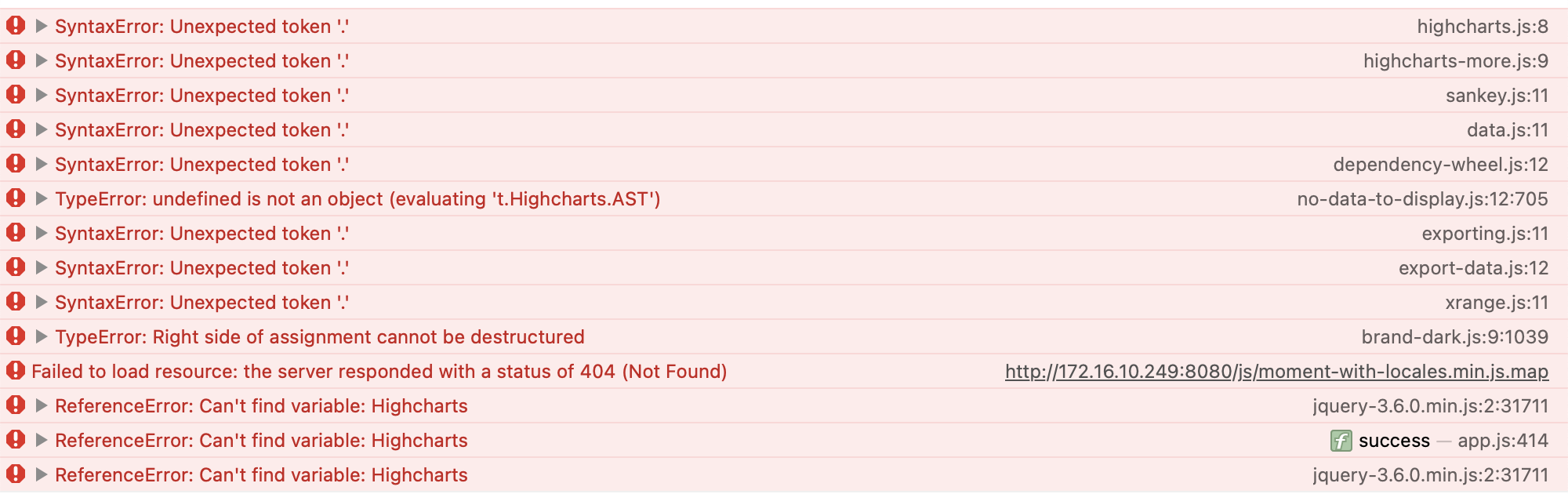

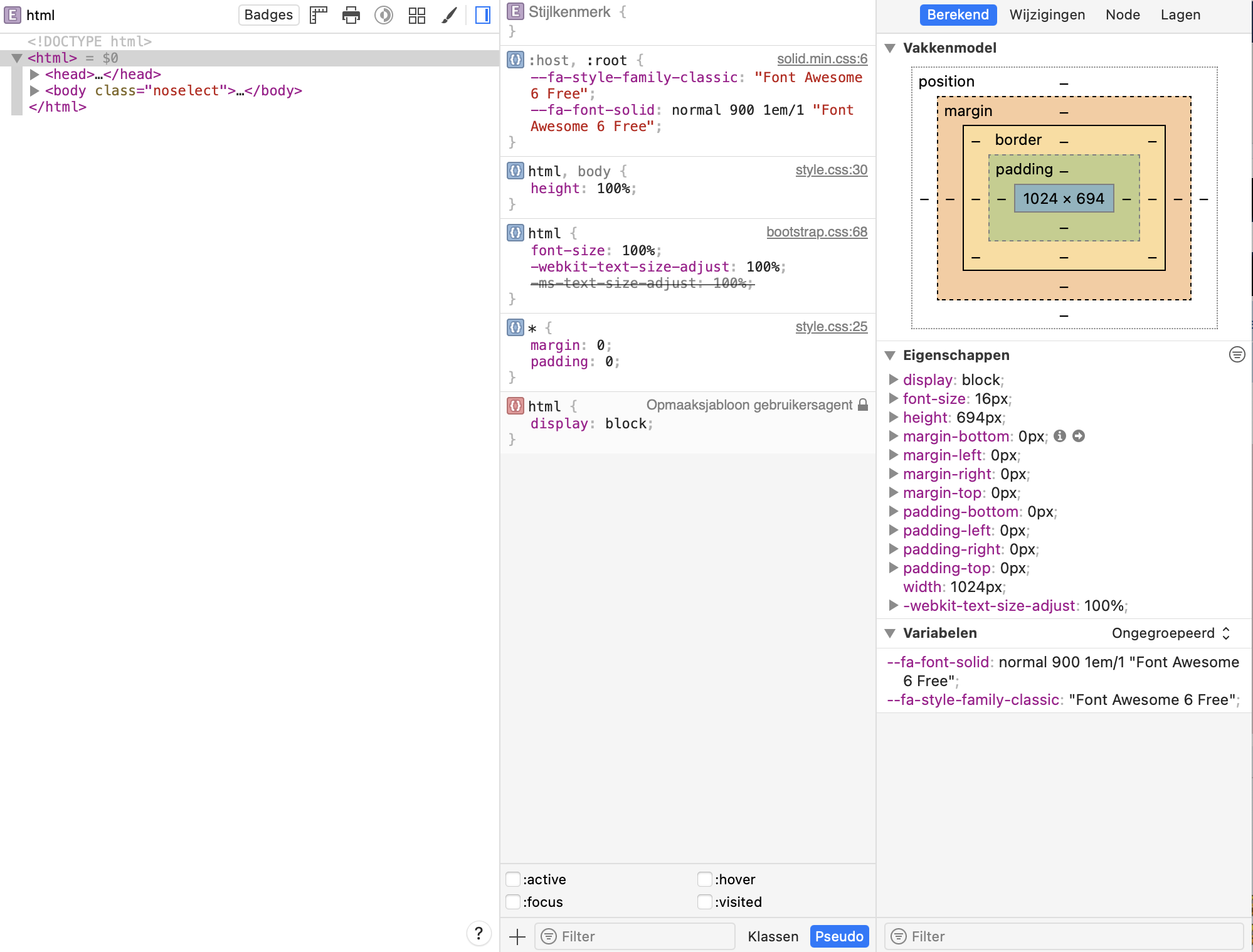

Is there a browser debug option on an Ipad? Can you see the errors that the browser should encounter?
njlammerts
- Posts: 153
- Joined: Wednesday 12 August 2020 17:13
- Domoticz version: 2022.2
- Location: Fryslan
Re: [2025.1] Ipad Air not working with 2025.1
i am able to remote connect to iPad mini:
On the ipad go to Settings > Safari > Advanced and activate the Web Inspector.
Connect your ipad with your computer.
On your computer open Safari, enable the developer tools in the settings. check the above menu for the tab Developer and find your iPad there.
- Posts: 6677
- Domoticz version: 2025.1
So this seems to be an issue with the Highcharts library that has been updated in Domoticz. And this updated library giving issues on old IOS devices.
