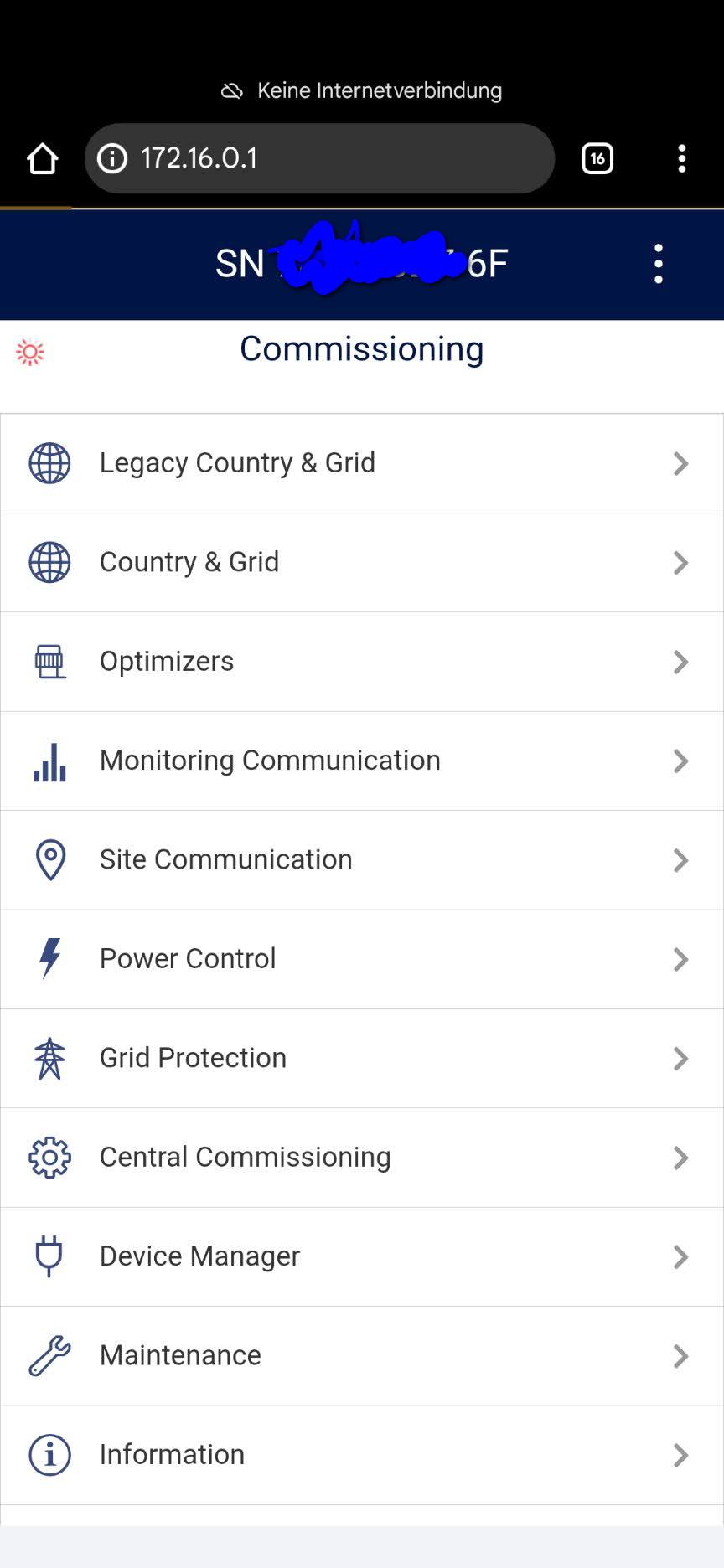

Where can I adjust that? I can access the inverter direktly via http://172.16.0.1 and have the menu according to attaches secrrenshot. But I do not find something like average calculation.Do you have the average calculation switched on in the hardware?

- jvdz
- Posts: 2441
- Domoticz version: 4.107
Re: Total Energy via SolarEdge Modbus TCP
I meant in the domoticz hardware settings.
The plugin has a brunch of settings you can define.
