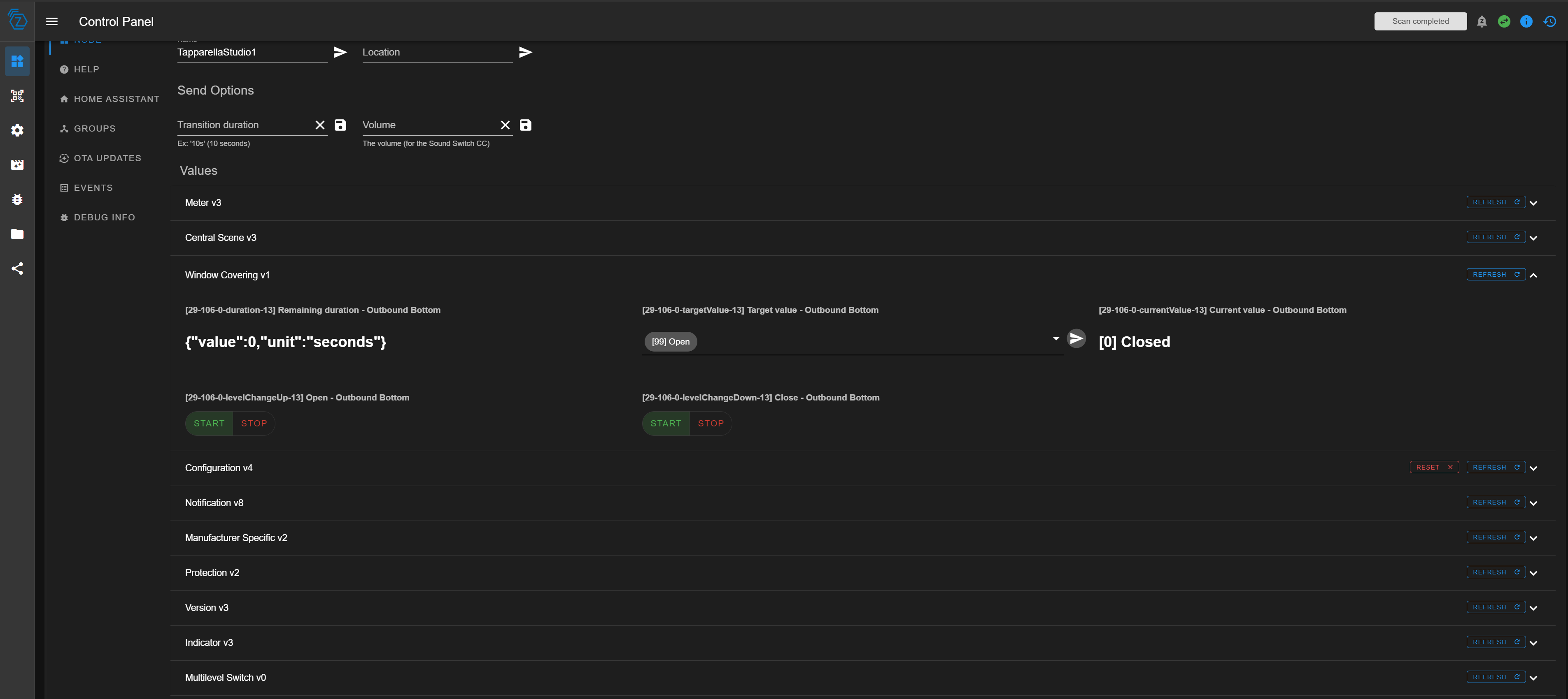

Hi there,
after a long time where everything has been working nicely, I decided to upgrade to the latest stable Domoticz, including ZWave-JS.
After some tinkering I got it working, or at least the most important devices seem to be working.
However, I still have some issues with some blinds. My blinds are partly controlled by Fibaro Roller Shutter 2 (FGR-222) and partly (4) by Fibaro Roller Shutter 4 (FGR-224).
The latter one is creating issues: it is correctly recognized by ZWave-JS and it can be controlled from there.
However, it seems it's using the "Window Covering v1" method (?) instead of the standard control of Roller Shutter 2 (Multilevel switch or just on/off switch), so that I can't control the FGR-224 directly from Domoticz (or at least I was not able to, as of today).
Does anyone of you successfully use this kind of controller with Domoticz?
Do you have any idea or suggestion about how to give the correct command to ZWave-JS?
Sending the a "[29-106-0-targetValue-13] Target value - Outbound Bottom" or "[29-106-0-levelChangeUp-13] Open - Outbound Bottom" command should be enough (as I manually do from ZWave-JS UI).
Thanks,
mantoz

According to these posts https://github.com/zwave-js/zwave-js/issues/6811 and https://github.com/zwave-js/zwave-js-ui/issues/3734 it seems something related to MQTT discovery in ZWave-JS-UI and not Domoticz, so this isn't probably the best spot to ask.
However, any suggestion is appreciated.
Thanks,
mantoz
