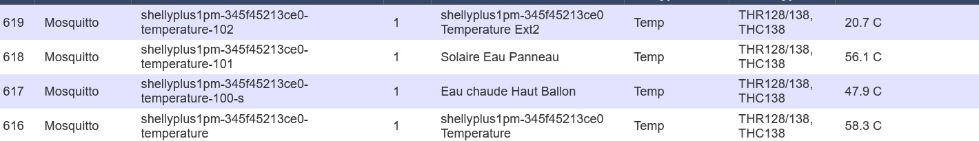

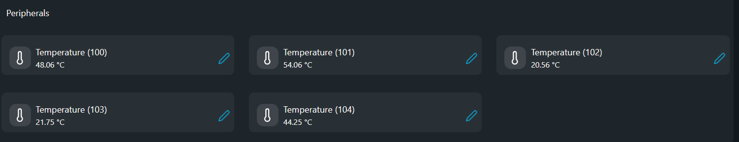

it should send me 5 temperatures.
the shelly web page has the 5 temperatures.

on Domoticz i only see 3 temperature devices plus the device temp.
I missed something, please help me if you have an idea.
