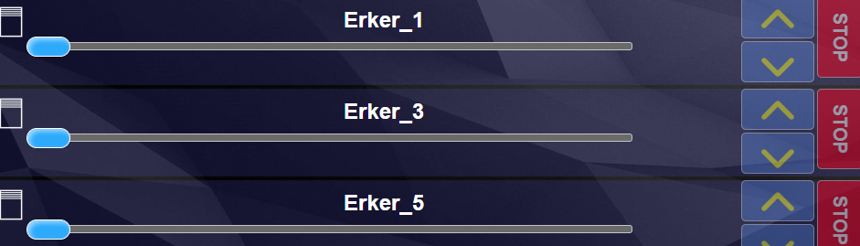

Hi Lokonli,
I noted the following during update to 3.14.1 beta.

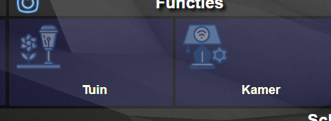

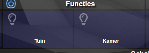

The group icons are overruled
blocks[gr_tuin] 		= {width: 2, hide_data : true, last_update : false, image: 'patrick/blue_garden.png', title:'Tuin'}
blocks[gr_kamer] 		= {width: 2, hide_data : true, last_update : false, image: 'patrick/blue_desk_lamp.png', title:'Kamer'}
2025-04-06 10_33_06-Dashticz.png (49.67 KiB) Viewed 2813 times
2025-04-06 10_33_24-Dashticz.png (51.45 KiB) Viewed 2811 times

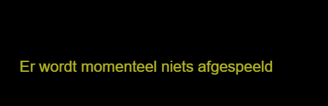

With the Logitech Media server i had a empty line when switched off, but his now giving a text
blocks['lms'] 			= {idx: 480, width : 8,iconOn: 'fas fa-volume-down fa-beat', iconOff: ' '}
2025-04-06 10_35_52-Dashticz.png (4.1 KiB) Viewed 2811 times

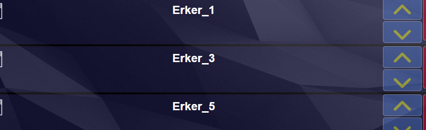

The block heights are now overrruled from my .css file
The mouse over is correct, but the normal block height is not smaller

Lokonli
Posts: 2292
Re: Dashticz v3.14.1-beta
Post by Lokonli »
ok, thanks for testing.
Last minute I had added a small bugfix, which unfortunately has some side effects.
It's a signal however that the code has become too complex, and that the current approach of manual testing is not sufficient anymore.
So, i decided to:
1) Implement an automatic testing framework. The idea is that all examples in the Dashticz documentation will be tested after every change. I've implemented the first 5 tests at the moment.
2) Another redesign of the software code for handling the Domoticz devices.
Next update will follow soon.

Lokonli
Posts: 2292
Post by Lokonli »
madpatrick wrote: Sunday 06 April 2025 10:40 Hi Lokonli,

I had to change the CSS classes slightly because in the new Dashticz version a Domoticz block can consist of multiple lines, meaning the height of a block should be able to grow.
You can change your styling to:
.transbg {
	background-color : rgba(77,77,222,0.2) !important;
        padding-top : 8px !important;
	padding-bottom : 6px !important;
	border : 2px solid rgba(255,255,255,0) !important;
	border-radius : 1px !important;
.mh {
	height: 100px !important;
	text-align : center !important;
.transbg.hover:hover {
        font-size: 26px !important;
Lokonli
Posts: 2292
Post by Lokonli »
madpatrick wrote: Sunday 06 April 2025 10:40 With the Logitech Media server i had a empty line when switched off, but his now giving a text
Probably fixed in 3.14.4.
Can you test? (I don't have a LMS)

madpatrick
Posts: 758
Domoticz version: 2025.2
Post by madpatrick »
Hi Lokonli,
Thanks for the update.
It looks better now, but not all good for me yet.
Probably some setup issues which need to sort out.
The block are good now and needs a little bit tweaking
The LMS text is now ok, but needs a bit more testing when the music is playing
[EDIT]
The LMS text is ok

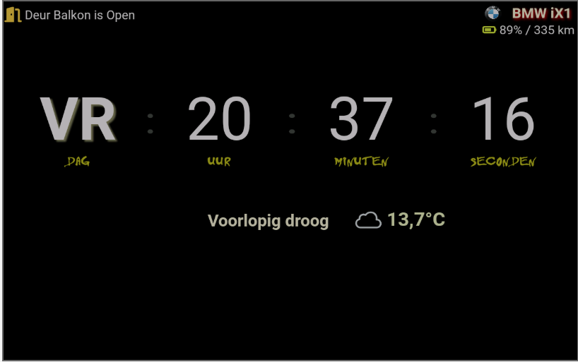

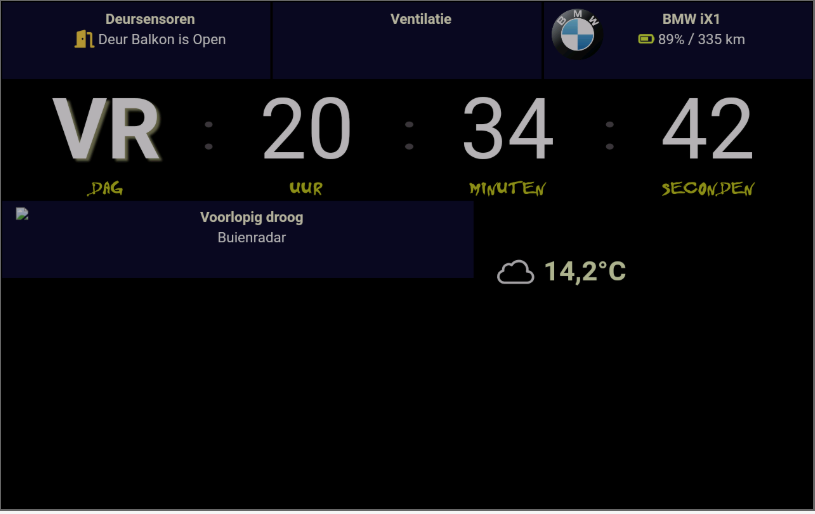

The standby screen is now mangled
[EDIT]
THe problem looks to appear in the TEXTBLOCK
Old version
New version

madpatrick wrote: Friday 18 April 2025 20:42 Hi Lokonli,
[EDIT]
The LMS text is ok
[EDIT]
Old version
New version
/* --------------------------------------------------------------------------- STANDBY BACKGROUND --------------------------------------------------------------------------- */
.screenstandby 					{background-color: black !important}
/* --------------------------------------------------------------------------- STANDBY SCREEN --------------------------------------------------------------------------- */
.standby .block_textblock1 			{height: 150px !important;background-color: rgba(0,0,0,1) !important;text-align: left !important}
.standby .block_textblock1 .title 		{display: none !important}
.standby .block_textblock1 .value 		{font-size: 22px !important;color:white !important; display:inline-block;position: relative; left: -50px !important;top: -15px !important;}
.standby .block_textblock2 			{height: 150px !important;background-color: rgba(0,0,0,1) !important}
.standby .block_textblock2 .title 		{display: none !important}
.standby .block_textblock2 .value 		{font-size: 22px !important;color:white !important;text-align: center !important;top: -15px !important;}
.standby .block_textblock3 			{height: 150px !important;background-color: rgba(0,0,0,1) !important}
.standby .block_textblock3 .title 		{font-size: 26px !important;position: fixed;top:  5px;right: 10px;text-align: right !important;text-shadow: 2px 2px 5px #FF0000 !important}
.standby .block_textblock3 .value 		{font-size: 22px !important;position: fixed;top: 40px;right:  5px;text-align: right !important;}
.standby .block_textblock3 img			{position: fixed;top: 8px;right: 135px;text-align: right !important;max-width: 30px !important;}
.block_textblock2 .value 			{font-size: 22px !important;color:white !important;display:inline-block;position: relative;top: -15px !important;}
.standby [data-id='myclock']			{height: 150px !important;background-color: rgba(0,0,0,1) !important;}
.standby [data-id='myclock'] .clock-day		{color: rgba(250, 190, 190, 1) !important;text-shadow: 4px 3px 3px #8c8c64 !important;font-weight: bold !important;}
.standby [data-id='myclock'] .clock-hours	{color: rgba(242, 242, 242, 1) !important;}
.standby [data-id='myclock'] .clock-minutes	{color: rgba(242, 242, 242, 1) !important;}
.standby [data-id='myclock'] .clock-seconds 	{color: rgba(179, 179, 179, 0.6) !important;}
.standby [data-id='myclock'] .clock-label	{color: rgba(200, 200, 0, 1) !important;font-weight: bold;font-family: "floydian"}
.standby .block_regen 				{font-family: Arial !important;height: 180px !important;display:flex;align-items:center;text-align: right !important;background-color: rgba(0,0,0,1) !important}
.standby .block_regen .title 			{font-size: 30px !important;rgba(244, 255, 204, 0.5) !important;}
.standby .block_regen .value 			{display: none}
.standby .block_regen img			{display: none}
.standby [data-id='weather_standby'] 		{font-family: Arial !important;height: 180px !important;background-color: rgba(0,0,0,1) !important}
.standby [data-id='weather_standby'] .icon	{font-size: 24pt !important;padding-left: 10px !important}
.standby [data-id='weather_standby'] .temp	{font-family: Arial !important;font-weight: bold;font-size: 26pt !important;color:#f4ffcc;}
.standby .weather .icon				{max-width: 80px !important;}
.standby .weather .temp				{font-family: Arial !important;font-weight: bold;font-size: 26pt !important;color:#f4ffcc;}
.standby .block_sunrise		 		{height: 80px !important;display:flex;align-items:center;text-align: center !important;background-color: rgba(0,0,0,1) !important}
.standby .wi-sunrise:before 			{font-size: 32pt !important; color: yellow; !important;padding-left: 40px !important;}
.standby .wi-sunset:before  			{font-size: 32pt !important; color: orange !important; padding-left: 30px !important;}
.standby .sunrise 				{font-size: 30pt !important; color: #f4ffcc !important;padding-left: 20px !important;}
.standby .sunset 				{font-size: 30pt !important; color: #f4ffcc !important;padding-left: 20px !important;}
.standby .block_lms				{height: 150px !important;display:flex;align-items:center;text-align: left !important;padding-top: 100px !important;background-color: rgba(0,0,0,1) !important}
.standby .block_lms .icon 			{max-width: 40px !important;color: #89CCFF !important}
.standby .block_lms .col-data			{color : yellow !important;display:flex;align-items:center;text-align: left !important;}
.standby .block_lms .title 			{display: none}
.standby .h4.h4 				{font-size:22px;}
I expect these issues have been solved in latest version.
Could you retest?

madpatrick
Posts: 758
Hi Lokonli,
Found another issue
My sliders are gone
.ui-slider-handle 				{padding: 6px 10px 6px 10px !important;background-color: #00aaff !important;border-color: white !important;border-radius: 14px;height: 22px !important;width: 48px !important;box-shadow: inset 3px 3px 5px 0px rgba(255,255,255,0.5)}
.ui-slider-horizontal 				{background-color: #6a6a6a !important;border-color: #ffffff;max-width: 85% !important;}
2025-04-25 20_39_32-Dashticz.png (107.08 KiB) Viewed 2050 times
2025-04-25 20_40_06-Dashticz.png (97.69 KiB) Viewed 2050 times
Lokonli
Posts: 2292
Post by Lokonli »
madpatrick wrote: Friday 25 April 2025 20:40 Hi Lokonli,
Found another issue
My sliders are gone
Fixed in latest version.
I've slightly changed (improved) the CSS definition of the stop button, to make the height 100% correct.
You may have to adjust your css styling as well a bit.
madpatrick
Posts: 758
Thanks for the quick fix.
How can i adjust the stop button ?
.btn-number.stop 				{width: 88px !important;height: 50px !important; border: 1px solid rgba(255,255,255,0.7);background: red; border-radius: 5px;font-size:20px !important;}
When i change the size it doesn't work

madpatrick wrote: Saturday 26 April 2025 11:34 Thanks for the quick fix.
I will make styling a bit easier.
Can you add the following to custom.css for testing:
.mh {
    --col1width: 30px;
    --col2width: 30px;
.right2col {
    padding-right: calc(var(--col1width) + var(--col2width) + 8px);
.col-button2 {
    width: calc(var(--col1width) + var(--col2width));
.col-button2 .btn-number {
    width: var(--col1width);
.btn.stop {
    width: var(--col2width);
    font-size:20px;
    display: flex;
    justify-content: center;
    align-items: center;
/*Only change below this line*/
.mh {
    --col1width: 60px;
    --col2width: 60px;
.mh .btn {
    background-color: #00aaff;
    border-radius: 5px;
.mh .btn.stop {
    background-color: red;
You can change the width of the up/down and stop button via the two parameters: now they are 60px.
The styling can be done via ".mh .btn", or via ".mh .btn.stop" for the stop button only.
If this is working for you let me know, and I'll include in the next version.
