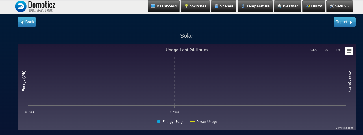

hi there for some reason graphs are not updating for virtual-device (energy counter). I used this method for years but it does not seam to work in the newer versions domoticz .

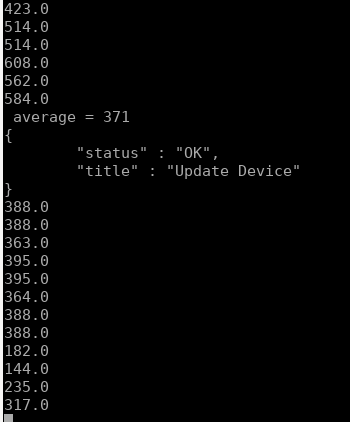

perl script that takes a live MQTT feed and publishes it to domoticz
what the code does it take a MQTT live feed from an energy monitor. , sample it then averages it over a certtian period then publishes it to domoticz and a second mqtt stream that an mqtt connected lcd screen displaying current data

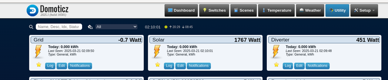

it publishes correctly and live data displays in domoticz but there never any entry points into the graphs.
it displays live data
but not the historical data
I have zigbee outlet switch with energy capabilities it displays historical energy usage

I compiled from the current dev to the current stable and it is the same. no graphs are drawn. when you first initiated the virtual device it draws one instantaneous block. but at the next graph update. that one block is gone... I will keep rolling back and see when it last worked. I have current version running on a device and it 2022.1 I believe another device had 2023.2 and it it was working as well

okay it seams that i forgot that I needed to enable compute now it seams to drawing my graphs
