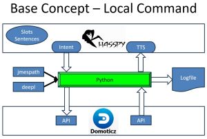

I've launched a plugin for integrating Rhasspy voice assistant with Domoticz. Plugin can be found (including extensive documentation) on https://github.com/TurnOfAFriendlyCard/ ... spy-Plugin. Rhasspy documentation can be found on https://rhasspy.readthedocs.io/en/latest/.
The plugin should be able to process next dialogue:
Question (spoken): Hey Jarvis put on the kitchen light
Result in Domoticz: the kitchen light is switched on
Response (spoken): The light in the kitchen is swithed on
Main topics:
  • Usage of MQTT to receive data from and send data to Rhasspy.
  • Define in Rhasspy what device in Domoticz to process.
  • Define in Rhasspy what base response to be spoken after processing in Domoticz.
  • Translate state of the device from local language in Rhasspy to local language in Domoticz (and vice versa).
  • Process requests via standard Domoticz API from and to the Domoticz database.
  • Process only Domoticz related requests via this plugin (so non Domoticz requests can be processed in a different way).
The base concept is below.
Integration Rhasspy Domoticz.jpg (109.84 KiB) Viewed 4666 times

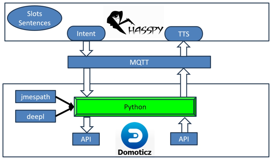

Rhasspy automatically installs Mosquitto MQTT broker for messaging between the Rhasspy modules running on that machine, called “Internal MQTT”. Because it is self-contained, it is set up with few settings; and is suitable where all the Rhasspy modules are running on the same machine.
So, either use that internal MQTT broker or use the external MQTT broker if it is already installed. And in v1 I've already enabled listening to MQTT messages triggering the intent of the Domoticz request. So I think it makes sense to apply the MQTT approach, however open for other opinions to go ahead.

Version 3.0 of the integration between Rhasspy and Domoticz is published. Two concepts are now available: 1) via Local Command option in Rhasspy and 2) via MQTT. Schematic looks like below:
Integration Rhasspy Domoticz - LC - small.jpg (13.83 KiB) Viewed 3074 times
Integration Rhasspy Domoticz - MQTT - small.jpg (15.01 KiB) Viewed 3074 times
Besides both concepts available, next functionality has been processed:
  • Extended speakreponse tag in Rhasspy sentence so own feedback can be configured combined with Domoticz data.
  • Added setpoint device, so update of temperature is possible.
  • Running MQTT script in background.
  • Introduced specific translation approach (where deepl misses the context).
