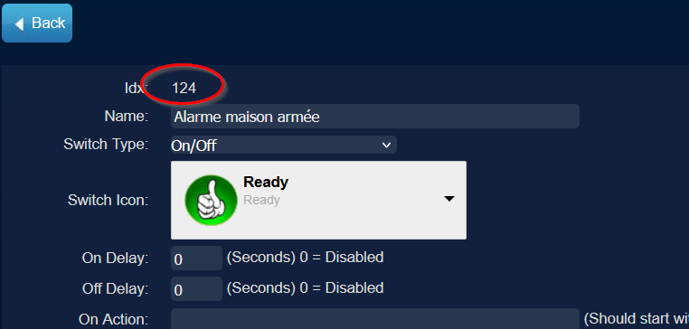

Example of a device, here #124

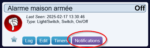

On the swich widget, the Notifications button has become purple instead of blue.

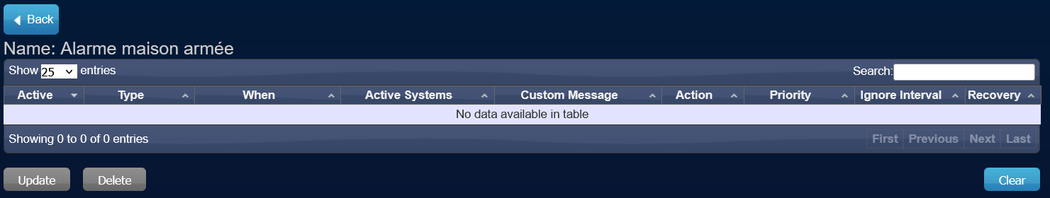

Click on notifications, and the list is now empty
notification disparue.png (28.61 KiB) Viewed 576 times
The database still contains the notification.

When clicking on this button:
notification confirmée.png (20.62 KiB) Viewed 546 times
I receive an empty list:
notification disparue.png (28.61 KiB) Viewed 546 times

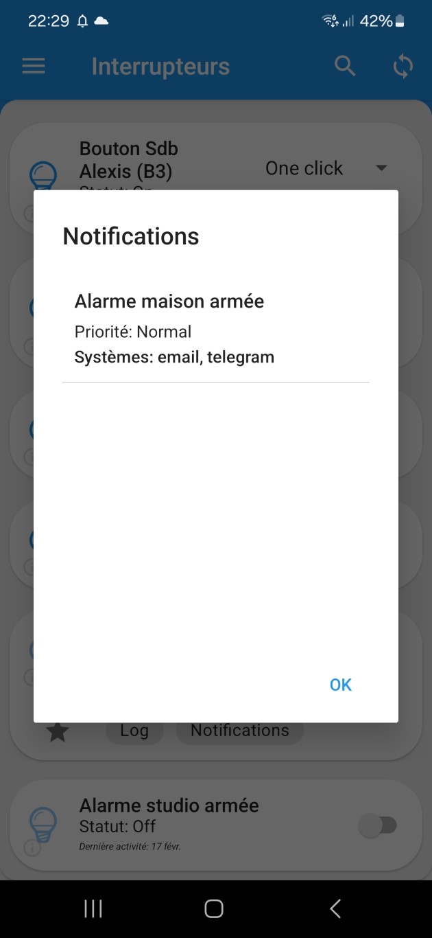

The Android app shows the notification (before the reboot):
