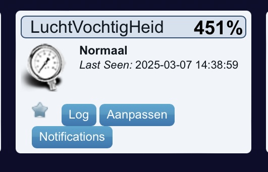

This sensor is a multisensor and shows temperature,humidity,co2,voc
And i want to get the values in domoticz but dont know how.
This is the tuya sensor
![Image]()
If you need more information let me know please.

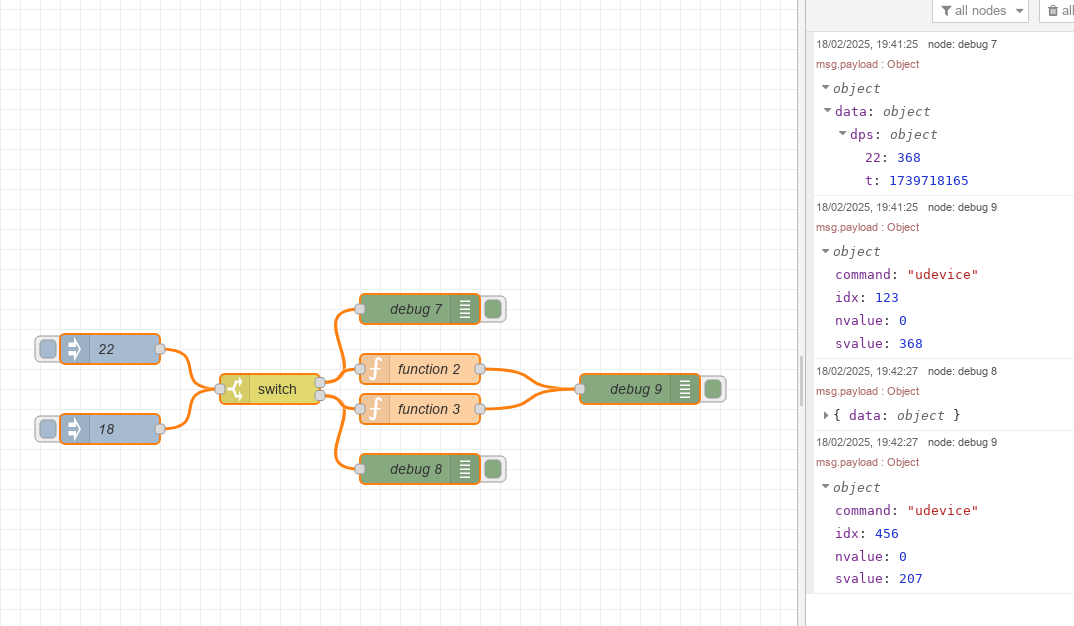

hello @edwin1234,
As you only sent some screenshot, I made a simulation as follows:
And below the flow:
Do the following.
1. For each sensor (with a number) add an extra output in the "Switch node
2. In the first line of the "Function" node insert the correct Domoticz IDX number
3. Replace the last Debug node with your own "MQTT Output" node.
Let me know, if this example helps.

]1. For each sensor (with a number) add an extra output in the "Switch node
Last edited by FireWizard on Tuesday 18 February 2025 22:20, edited 1 time in total.

I have added the humidity also from the same device. “Luchtkwaliteit” Its working but it shows 550 instead of 55% does some one knows how to correct get the decimal ?
Is that done in node red or domoticz ?
Edwin
Edwin

I don't understand the question, as "Air quality" has a value in PPM, and 550 sounds like an excellent air quality!edwin1234 wrote: Friday 07 March 2025 6:00 “Luchtkwaliteit” Its working but it shows 550 instead of 55%
Humidity, normally part/combined with a Temperature sensor, should be another Sensor type that you need to update.
Please show use the Device info of the Humidity Sensor device and how you update that.

I think, you receive the Humidity from the same sensor, that you called "Luchtkwaliteit". Obviously the Humidity sensor gives you an accuracy of 0.1 %. So 550 means 55.0%.
So you have to divide your value by 10. That is done in Node-RED.
However you can only send whole numbers and no decimals.
They are chopped of in Domoticz or you use the function toFixed() in Node-RED. And the Humidity sensor in Domoticz requires also an environment level, as second parameter.
This can be calculated in Node-RED as well.
What type of sensor, do you intend to use?

Yes firewizard its the same sensor
I choosed a dummy Humidity sensor for the humidity in domoticz
![Image]()
You see its working
You see its working
- 2B2C0538-CDE6-4709-B752-F34E262672BC.jpeg (44.71 KiB) Viewed 1697 times

You should send the following from Node-RED to Domoticz:
where the nvalue is the humidity and the svalue is the level
The nvalue should be without decimals.
So send the following:
where I assume that the msg.payload.humidity is the numeric value of the humidity, e.g. 451.
Try this
{"command":"udevice", "idx":1234, "svalue":"lv", "nvalue":hu}where the nvalue is the humidity and the svalue is the level
msg.payload = { "command": "udevice", "idx": 1234, "nvalue": parseInt(msg.payload.humidity / 10), "svalue": "0"};
return msg;Try this

Hi firewizard,
It
Works perfectly
Thanks for the answer
It
Works perfectly
