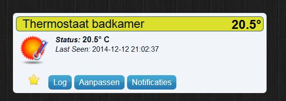

I can't get the set points available, and wondering why the square on the sensor is yellow?

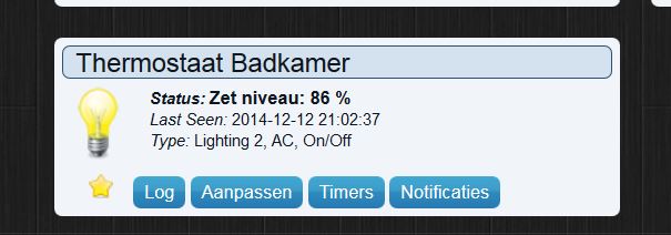

Below you find the icon of the thermostaat, a;;though its is showing the setlevel, but I can't get setpoint listed in "devices". I've included the device several times but no luck yet. Also saw in the device list that battery level stated "low", but the there are brand new?
Below you find the icon, with the yellow bar. What does this mean?

A setpoint device should show up under the utility tab (first in the devices tab)
Yellow means low battery, you should be able to see the level from the devices tab
