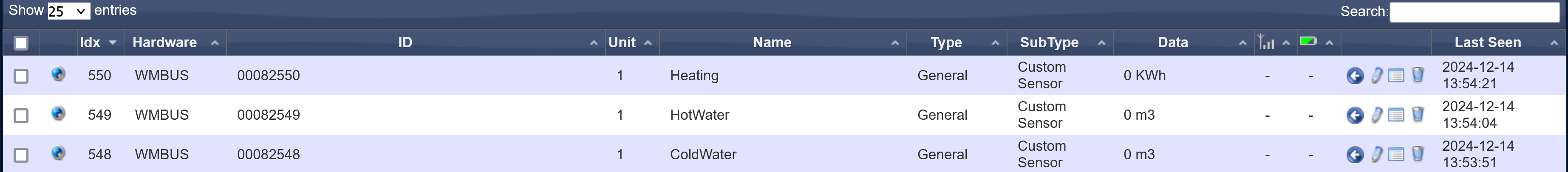

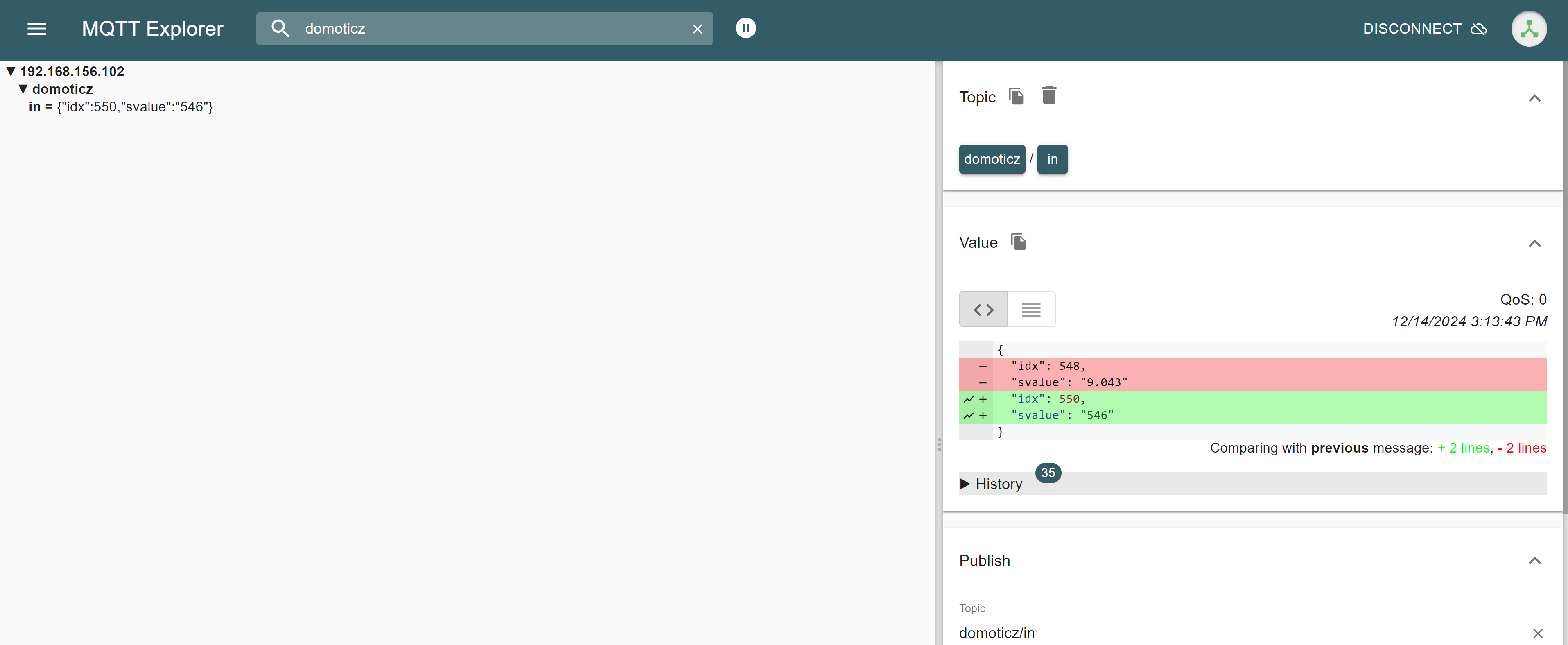

I feel i got stuck trying to deliver Wireless Mbus meters values to domoticz dummy device via mqtt. The wmbusmeters calls mosquitto_sub and posts the values for 3 counters into the mqtt domoticz/in topic. The problem i am facing is that dummy counters i created are not being updated on Domoticz side. Domoticz does not even show the mqtt message in the log however can see the messages with values posted in the mqtt explorer. The domoticz works fine with zigbee2mqtt meaning domoticz<->mqtt connection is operational. It seems that domoticz does not listen for domoticz/in topic for some reason
The example of the call i make when wmbusmeters read new value:
shell=/usr/bin/mosquitto_pub -u XX -P YY -h mqtt5 -t domoticz/in -m "{\"idx\":548,\"svalue\":\"$METER_TOTAL_M3\"}"
attaching screenshot of MQTT explorer and of Dummy devices i created in Domoticz.
I am on Domoticz Version: 2024.4
Please point me to the right direction. Thanks

interesting - i tried running tcpdump on the domoticz interface towards mosquitto and it appears that my messages sent with mosquitto_pub are not even reaching the domoticz
other messages ( zwave, zigbee) are reaching domoticz with no issues.
also tried posting messages with mqtt explorer - those i see on mosquitto_sub but nothing seen on tcpdump on domoticz side.
something for me to think about
