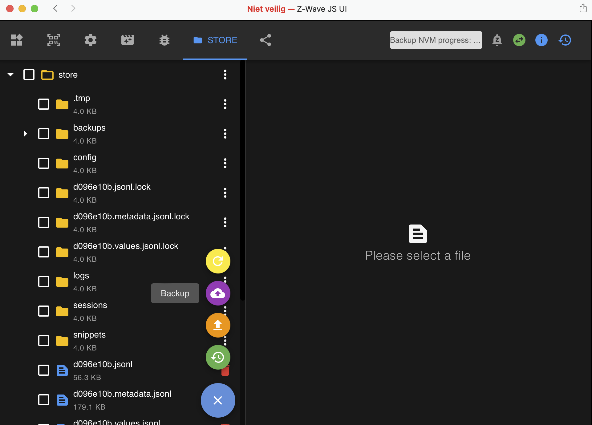

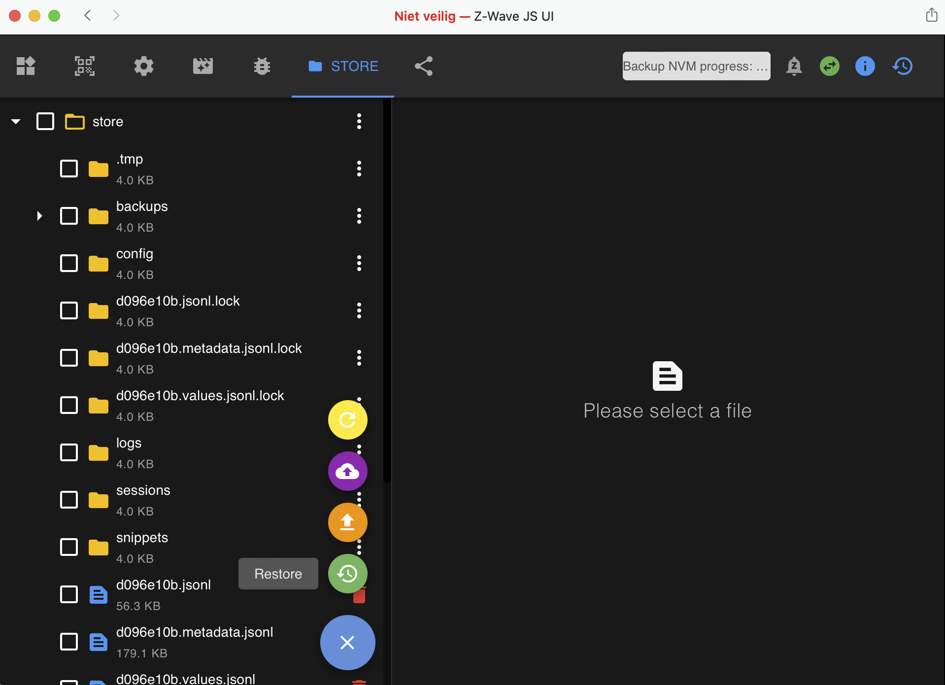

I just migrated from RPI3B to RPI5
On RPI3B, I had only zwave-js-ui running in a container, the rest Domoticz, mosquito, node-red and homebridge was plain installation.
I also have the zwave.me UZB stick on the RPI3B , I also used a rule for not changing the USB name.
On RPI5, I have all the applications installed via containers (Docker compose with docker-compose.yaml files).
I have a spare UZB stick, which I used to test the zwavejs-ui container and used the - '/dev/serial/by-id/usb-0658_0200-if00:/dev/zwave' in the docker-compose file.
After configuring all the other containers, I have exported and imported the Domoticz data base from RPI3B into RPI5 and from the UI of zwavejs-ui I made a backup from the store from 3RPIB and restored these settings in the new container on RPI5.
Then I shutdown the RPI5 system and installed the UZB stick from the RPI3B system and all the devices were there.
After a few minutes the system was working fine.

As you are working on docker you only need to transfer the store as theo11 also explained. And the export/import settings functionality does that for you so you cannot make mistakes.
So perhaps restart the new Zwave-JS-UI docker from scratch and only move to store through the export/import functions.

theo11
- Posts: 18
- Joined: Saturday 11 April 2020 11:23
- Domoticz version: 2026.4
- Location: Netherland
Re: Migration of Zwavejs-ui from RPI3 to RPI4
Hi Michel,
I did a fresh install of the zwave-js-ui container, with a spare UZB stick.
Then I made a backup of the store my old container in the zwave-js-ui store menu: Then on the new container I restored the store also in in the zwave-js-ui store menu: Good luck,
Theo.
Theo.

Michel13
- Posts: 88
- Joined: Thursday 07 January 2016 19:31
- Location: France
Thanks theo11 for these explanations.
I am not really used to the Zwave-JS-UI interface, so I had not noticed the "+" button at the bottom of this page and what it was hiding.
I followed the procedure and as I feared, it still does not work.
