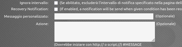

Schermata del 2024-12-05 10.29.45.png (58.17 KiB) Viewed 1427 times
OK I will try to put the script in this box.
Sorry for the late reply but I do not receive notifications.
