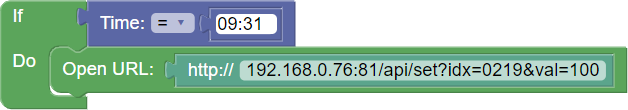

This Blockly block updates a parameter (0219) with fixed value = 100 and works OK. But I want to use an existing user variable instead of the fixed value in the URL. Is this possible in Blockly and what would I write as "val=" ???

First create a new global variable in setup>user variables. Give it type "float". Then set it to 100 in Blockly using Logic>Set and Devices>User variables and choosing from the 4 options corresponding to the first letter of your variable.

Thank you "solarboy" for your reply. I already have a Blockly that updates the user variable. Now, what I want to do is use thatvariable as the value ("val=") in the http request but I dont know how to correctly format it....

not a direct answer but I would advice to use dzVents being very flexible. And yes it has a learning curve .....

I finally got dzVents to work. This is the code for setpoint to Husdata (heatpump interface). To set temperature, you must multiply with 10. To set 10 degrees, send 100. I dont check for same value because I dont use the timer....
devices = { 'Set Pool Temp' },
--timer = { 'on every 2 minutes' }
local setpoint = domoticz.devices('Set Pool Temp').setPoint
local NewParallel = (setpoint)*10
--local ActualParallel = tonumber(domoticz.devices('Parallel').state)
--if NewParallel/10 ~= ActualParallel then
domoticz.openURL('http://xxxx.tplinkdns.com:xx/api/set?idx=0219&val=' .. NewParallel)
