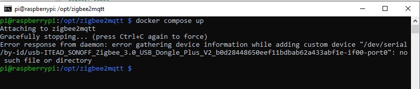

after command docker compose up :
Attaching to zigbee2mqtt
Gracefully stopping ... (press Ctrl+C again to force
Error response from daemon: error gathering device information while adding custom device "/dev/serial/by-id/usb-Itead_Sonoff_Zigbee_3.0_USB_Dongle_Plus_V2_b0d28448650eef11bdbab62a433abf1e-if00-": no such file or directory
how can I correct this

Re: SONOFF ZigBee 3.0 USB Dongle Plus - E docker fails
Could be you made a typing error in your usb path as it looks like the path in the error is not the same as in your docker compose file. Error has a dash on the end.
Edit: And I think you also missed the -port0 so it should be:
/dev/serial/by-id/usb-Itead_Sonoff_Zigbee_3.0_USB_Dongle_Plus_V2_b0d28448650eef11bdbab62a433abf1e-if00-port0

Walter, thanks for your advice. I did as you adviced but still same error.

BartSr wrote: Thursday 10 October 2024 9:59 Still problems to get Z2M up and runnig with new stick
     - /dev/serial/by-id/usb-ITEAD_SONOFF_Zigbee_3.0_USB_Dongle_Plus_V2_b0d28448650eef11bdbab62a433abf1e-if00-port0:/dev/ttyACM0
but still same error saying no such file or directory
this is result of ls /dev/serial/by-id
so I get stuck....
The shown device names are not equal as the beginning of these names have different Upper/Lowercase letters.
Try doing a copy&paste to ensure they are equal!

jvdz: stupid I overlooked. Updating helped. But now another error pops up:

the thing is that I get lost in the very detailled information about many different adapters etc. don't know how to find my way overthere
(just lack of knowledge at my site)
update: yes I saw the remark but then I don't know how to deal with. Where to find current version? Flash stick? yes? how?
So many different ways to do with risk of damage stick?

Hello, a newbe (in domoticz country) here. Maybe this is the fault. It's Linux so capital sensitive. You wrote (I think) you device id wrong:
You wrote the T not in capital.
This is mine device id:
usb-ITead_Sonoff_Zigbee_3.0_USB_Dongle_Plus_004fcced0e86ec11a909591719c2d21c-if00-port0
I hope this will fix the issue.

Sorry, no. If I follow your advice then error no such file of directory is back.

Its simple: the name needs to be exactly what is listed as output for: ls /dev/serial/by-id

exact, that's what I learnt from this thread

for the records:
problem solved!
I installed zigbee2mqtt on a headless system.
I was nod aware it was a raspberry 2.
After upgrading to a raspberry 3+ it all works as expected.
