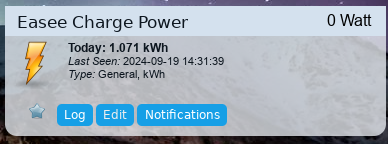

To get the data of my Easee Charger (Easee Home), I use Node-RED with the contrib node:
https://flows.nodered.org/node/@runnane ... trib-easee.
As you will receive almost everything, I filter the desired data and send it by MQTT to Domoticz.
For documentation, see: https://developer.easee.com/docs/integrations
see picture below:
Screenshot_Easee Charge.png (54.55 KiB) Viewed 3317 times
