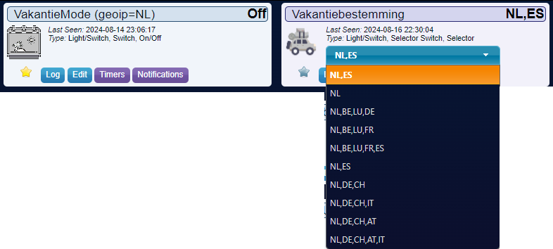

- Posts: 270
- Joined: Thursday 14 March 2024 10:11
- Domoticz version: 2025.1
Re: Can a selector levelname be changed with script?
Great idea. But the result is more complicated then I thought.
It apears that the options are send as an encoded string. See the options part.
https://MyDomain:MyPort/json.htm?addjvalue=0&addjvalue2=0&customimage=144&description=&idx=1037&name=Vakantiebestemming&options=TGV2ZWxOYW1lczpOTCxCRXxOTCxCRSxMVSxERXxOTCxCRSxMVSxGUnxOTCxCRSxMVSxGUixFU3xOTCxFU3xOTCxERSxDSHxOTCxERSxDSCxJVHxOTCxERSxDSCxBVHxOTCxERSxDSCxBVCxJVDtMZXZlbEFjdGlvbnM6fHx8fHx8fHw7U2VsZWN0b3JTdHlsZToxO0xldmVsT2ZmSGlkZGVuOmZhbHNl¶m=setused&protected=false&strparam1=&strparam2=&switchtype=18&type=command&used=true
LevelNames:NL,BE|NL,BE,LU,DE|NL,BE,LU,FR|NL,BE,LU,FR,ES|NL,ES|NL,DE,CH|NL,DE,CH,IT|NL,DE,CH,AT|NL,DE,CH,AT,IT;LevelActions:||||||||;SelectorStyle:1;LevelOffHidden:false
So far so good. It works, but I have to refresh to see the new value.
if dz.devices(vacation_idx).state == 'Off' then
-- Destination changed, but VacationMode not started but set.
if dz.devices(destination_idx).levelVal > 0 then
--Set the defaultSelectorOpotions in a string.
local defaultSelectorOptions = 'LevelNames:LEVEL0|NL|NL,BE,LU,DE|NL,BE,LU,FR|NL,BE,LU,FR,ES|NL,ES|NL,DE,CH|NL,DE,CH,IT|NL,DE,CH,AT|NL,DE,CH,AT,IT;LevelActions:|||||||||;SelectorStyle:1;LevelOffHidden:false'
-- Get destination from the selected item.
local destination = dz.devices(destination_idx).levelName --get destination from selection.
--Replace LEVEL0 in the string by this selection.
local stringToEncode = string.gsub( defaultSelectorOptions, "LEVEL0", destination )
--Encode the new string.
local encodedString = _u.toBase64( stringToEncode )
--Change the deviceoptions.
dz.executeShellCommand('curl "http://127.0.0.1:portnumber/json.htm?addjvalue=0&addjvalue2=0&customimage=144&description=&idx=' ..destination_idx .. '&name=Vakantiebestemming&options=' .. encodedString .. '¶m=setused&protected=false&strparam1=&strparam2=&switchtype=18&type=command&used=true" ')
-- Select level 0, to that the switch icon is off. It will be turned on when VacationMode starts.
dz.devices(destination_idx).switchSelector(0) --goto level 0
